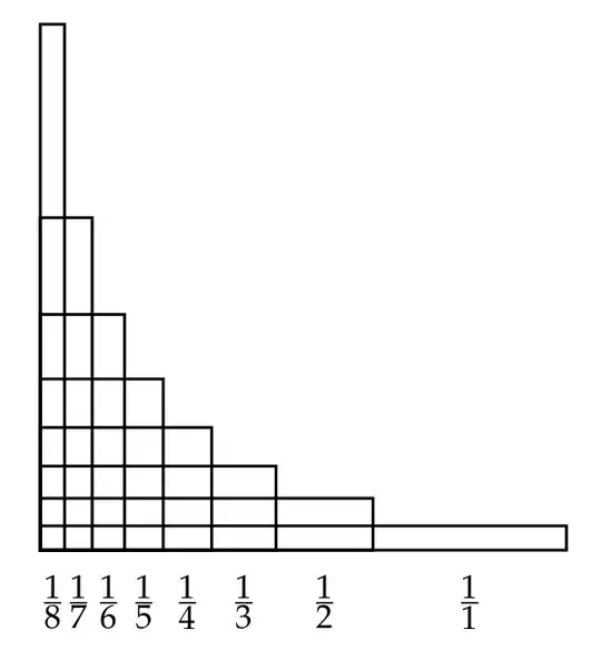

This is not really an answer, but rather a long comment prompted by David Speyer's answer. The proof that David gives seems to be the one in How to compute $\sum 1/n^2$ by solving triangles by Mikael Passare, although that paper uses a slightly different way of seeing that the area of the region $U_0$ (in Passare's notation) bounded by the positive axes and the curve $e^{-x}+e^{-y}=1$, $$\int_0^{\infty} -\ln(1-e^{-x}) dx,$$ is equal to $\sum_{n\ge 1} \frac{1}{n^2}$.
This brings me to what I really wanted to mention, namely another curious way to see why $U_0$ has that area; I learned this from Johan Wästlund. Consider the region $D_N$ illustrated below for $N=8$:
A shape with area = sum of reciprocal squares
Although it's not immediately obvious, the area of $D_N$ is $\sum_{n=1}^N \frac{1}{n^2}$. Proof: The area of $D_1$ is 1. To get from $D_N$ to $D_{N+1}$ one removes the boxes along the top diagonal, and adds a new leftmost column of rectangles of width $1/(N+1)$ and heights $1/1,1/2,\ldots,1/N$, plus a new bottom row which is the "transpose" of the new column, plus a square of side $1/(N+1)$ in the bottom left corner. The $k$th rectangle from the top in the new column and the $k$th rectangle from the left in the new row (not counting the square) have a combined area which exactly matches the $k$th box in the removed diagonal: $$ \frac{1}{k} \frac{1}{N+1} + \frac{1}{N+1} \frac{1}{N+1-k} = \frac{1}{k} \frac{1}{N+1-k}. $$ Thus the area added in the process is just that of the square, $1/(N+1)^2$. Q.E.D.
(Apparently this shape somehow comes up in connection with the "random assignment problem", where there's an expected value of something which turns out to be $\sum_{n=1}^N \frac{1}{n^2}$.)
Now place $D_N$ in the first quadrant, with the lower left corner at the origin. Letting $N\to\infty$ gives nothing but the region $U_0$: for large $N$ and for $0<\alpha<1$, the upper corner of column number $\lceil \alpha N \rceil$ in $D_N$ lies at $$ (x,y) = \left( \sum_{n=\lceil (1-\alpha) N \rceil}^N \frac{1}{n}, \sum_{n=\lceil \alpha N \rceil}^N \frac{1}{n} \right) \sim \left(\ln\frac{1}{1-\alpha}, \ln\frac{1}{\alpha}\right),$$ hence (in the limit) on the curve $e^{-x}+e^{-y}=1$.
Hans Lundmark

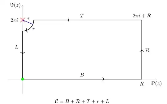

Consider the Basel Problem $$S=\sum^{\infty}_{n=1}\frac{1}{n^2}$$ we may note that the Laplace transform of $x$ gives a similar form to the series as follows $$\mathcal{L}\left\{x\right\}(n)=\frac{1}{n^2}=\int^{\infty}_{0}xe^{-nx}\text{ d}x,\qquad n>0$$ Since our sum violates no restrictions, we may substitute this integral into it giving \begin{align} S&=\sum^{\infty}_{n=1}\int^{\infty}_{0}xe^{-nx}\text{ d}x\\ &=\int^{\infty}_{0}x\sum^{\infty}_{n=1}e^{-nx}\text{ d}x\\ &=\int^{\infty}_0\frac{x\text{ d}x}{e^x-1}=I \end{align} Showing the integral and sum interchange is valid in $(2)$ is trivial since our integrand is always positive along the integration interval, and would simplify to the Basel Problem when the Fubini–Tonelli theorem is applied. $(3)$ on the other hand is a trivial geometric series.
How should we evaluate this integral? To do this, we will consider the rather counterintuitive function $$f(z)=\frac{z^2}{e^z-1}$$ This function has poles at every $z=2\pi i n$, $n\in\mathbb{Z}$, but notice that the "pole" at the origin actually is a removable singularity, which can be shown by taking the limit of the function as it goes to the origin. This means that when we set up our rectangular contour, we don't actually need to take the principal value to the origin through a circular indent, because the function is well behaved there and the integral along that circular indent would go to $0$ regardless.
Hence, consider the following contour
$$\oint_{\mathcal{C}}f(z)\text{ d}z=\int_B+\int_{\mathcal{R}}+\int_T+\int_r+\int_Lf(z)\text{ d}z=0$$ Parameterization of the contour gives \begin{alignat*}{5} B&:\text{ }z=x,\qquad &\text{d}z&=\text{d}x,\qquad &x&\in[0, R\,]\\ \mathcal{R}&:\text{ }z=R+iy,\qquad &\text{d}z&=i\text{ d}y,\qquad &y&\in[0, 2\pi]\\ T&:\text{ }z=2\pi i+x,\qquad &\text{d}z&=\text{d}x,\qquad &x&\in[R, \epsilon\,]\\ r&:\text{ }z=2\pi i+\epsilon e^{i\theta},\qquad &\text{d}z&=i\epsilon e^{i\theta}\text{ d}\theta,\qquad &y&\in\left[0, -\frac{\pi}{2}\right]\\ L&:\text{ }z=iy,\qquad &\text{d}z&=i\text{ d}y,\qquad &y&\in[2\pi-\epsilon, 0] \end{alignat*} Instead of evaluating these integrals one by one however, this time we will first begin by adding two of them and cancelling terms, which is the reason why we increased the numerator power by $1$ in our $f(z)$. We have it such that \begin{align} \lim_{R\to+\infty,\,\epsilon\to+0}\int_B+\int_Tf(z)\text{ d}z&=\lim_{R\to+\infty,\,\epsilon\to+0}\int^R_0\frac{x^2\text{ d}x}{e^x-1}+\int_R^{\epsilon}\frac{(2\pi i+x)^2\text{ d}x}{{e^{2\pi i}}e^x-1}\\ &=\int^{\infty}_0\frac{x^2\text{ d}x}{e^x-1}-\int_0^{\infty}\frac{(2\pi i+x)^2\text{ d}x}{e^x-1}\\ &={\int^{\infty}_0\frac{x^2\text{ d}x}{e^x-1}}-{\int^{\infty}_0\frac{x^2\text{ d}x}{e^x-1}}-\int^{\infty}_0\frac{4\pi i x\text{ d}x}{e^x-1}+\int^{\infty}_0\frac{4\pi^2\text{ d}x}{e^x-1}\\ &=-4\pi iI+\int^{\infty}_0\frac{4\pi^2\text{ d}x}{e^x-1} \end{align} Next, we have \begin{align} \left|\int_{\mathcal{R}}f(z)\text{ d}z\right|&\le\int^{2\pi}_0\frac{\left|R+iy\right|^2\cdot{|i|}\text{ d}y}{\left|\displaystyle e^R e^{iy}-1\right|}\\ &\le\int^{2\pi}_0\frac{R^2+y^2}{\left|\left|\displaystyle e^R\right|{\left|e^{iy}\right|}-|1|\right|}\text{ d}y\\ &=\int^{2\pi}_0\frac{R^2+y^2}{e^R-1}\text{ d}y=\frac{2\pi\left(4\pi^2+3R^2\right)}{3\left(e^R-1\right)} \end{align} So this integral is just $0$ since $$\frac{2\pi}{3}\lim_{R\to+\infty}\frac{4\pi^2+3R^2}{e^R-1}=0$$ The integral about $r$ gives $$\int^{-\frac{\pi}2}_0\frac{\left(2\pi i + \epsilon e^{i\theta}\right)^2}{{e^{2\pi i}}e^{\epsilon e^{i\theta}}-1}\cdot i\epsilon e^{i\theta}\text{ d}\theta$$ Fix a $-\frac{\pi}2\le\theta\le0$, and we can bound the denominator and then the whole integrand by a constant since the integral is over a finite interval, which allows us to swap the $\epsilon$ limit and the integral. Meanwhile, the limit itself can be solved by L'Hôpital's rule, which yields $$\lim_{\epsilon\to+0}\int^{-\frac{\pi}2}_0\frac{\left(2\pi i + \epsilon e^{i\theta}\right)^2}{e^{\epsilon e^{i\theta}}-1}\cdot i\epsilon e^{i\theta}\text{ d}\theta=\int^{-\frac{\pi}2}_0\lim_{\epsilon\to+0}\frac{\left(2\pi i + \epsilon e^{i\theta}\right)^2}{e^{\epsilon e^{i\theta}}-1}\cdot i\epsilon e^{i\theta}\text{ d}\theta=4i\pi^2\int^0_{-\frac{\pi}{2}}\text{d}\theta=2i\pi^3$$ We have one more integral to go, where we can see that $$\lim_{\epsilon\to+0}\int_Lf(z)\text{ d}z=\lim_{\epsilon\to+0}\int^{0}_{2\pi-\epsilon}\frac{-y^2\cdot i\text{ d}y}{e^{iy}-1}=\int^{2\pi}_{0}\frac{iy^2\text{ d}y}{e^{iy}-1}$$ All in all, we end up with $$\oint_{\mathcal{C}}f(z)\text{ d}z=\int_B+{\int_{\mathcal{R}}}+\int_T+\int_r+\int_Lf(z)\text{ d}z=-4\pi iI+\int^{\infty}_0\frac{2\pi^2\text{ d}x}{e^x-1}+2i\pi^3+\int^{2\pi}_0\frac{iy^2\text{ d}y}{e^{iy}-1}=0$$ Note that the two unsolved integrals that remain are divergent, and will actually cancel each other out if we take a principal value "over" the two integrals, but we do not need to deal with them. Instead, we can pass the equation through the imaginary part function and equate the results, which give $$-4\pi I+2\pi^3+\int^{2\pi}_0\Im\left(\frac{iy^2}{e^{iy}-1}\right)\text{ d}y=0$$ We can separate real and imaginary parts of the integrand of the last integral with some simple conjugate multiplication, and we would end up with $$-4\pi I+2\pi^3+\int^{2\pi}_0\frac{-y^2\text{ d}y}{2}=0$$ $$I=S=\frac{-2\pi^3+\frac{4}{3}\pi^3}{-4\pi}=\boxed{\frac{\pi^2}{6}}$$
Max0815
