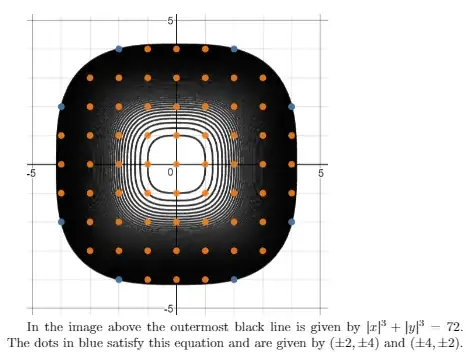

The technique I use below I reference quite a bit on this site and therefore am putting a nice explanatory picture. The technique is a type of "Diophantine Approximation" I suppose. I don't know if the technique goes by a special name.
We are going to count the number integer solutions along some Diophantine equation $P(x,y)=n$. If let $\phi_n$ denote the number of solutions in $\mathbb{Z}$ to $P(x,y)=n$ then we may argue (under some conditions) that $\sum_{n=1}^N \phi_n$ approximates the area of the interior of $P(x,y)=N$. Let me give a concrete example. Let $P(x,y)=|x|^3+|y|^3$.
The actual area in the interior of $|x|^3+|y|^3=72$ is given by $\frac{72\Gamma(1/3)^3}{4\sqrt{3}\pi} \approx 63.59899501$ and this is weakly approximated by $69$ which is the total number of integers which are on some solution of $|x|^3+|y|^3=n$ as $n$ varies from $0$ to $72$. Approximating this area as the number of integer solutions should improve as a we let $n$ grow large.
