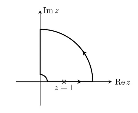

I have to calculate $$\int_0^\infty\frac{\log x dx}{x^2-1},$$
and the hint is to integrate $\frac{\log z}{z^2-1}$ over the boundary of the domain $$\{z\,:\,r<|z|<R,\,\Re (z)>0,\,\Im (z)>0\}.$$
I don't understand. The boundary of this domain has a pole of the integrand in it, doesn't it? Doesn't it make this method useless?

Following the hint, let $$f(z) = \frac{\log z}{z^2-1}$$ where $\log$ is the principal branch of the complex logarithm. Since $z=1$ is a simple zero for $z^2-1$ and $\log 1 = 0$, the function $f$ has a removable singularity at $z=1$.
Integrate $f$ along the contour. It's easy to check (using standard estimates) that the integral of $f$ along the two quarter-circles tend to $0$ as $R \to \infty$ and $r \to 0^+$. The function $f$ is holomorphic on and inside the contour, so Cauchy's integral theorem will give you (after passing to the limit)
$$ \int_0^\infty \frac{\log x}{x^2-1}\,dx - \int_0^\infty \frac{\log it}{(it)^2-1}\,i\,dt = 0 $$ i.e. $$ \int_0^\infty \frac{\log x}{x^2-1}\,dx = -\int_0^\infty \frac{\log t + i\pi/2}{t^2+1}\,i \,dt = \frac{\pi^2}{4} \tag{*}$$
using $\int_0^\infty \frac{\log t}{1+t^2}\,dt = 0$ (see e.g. this question) and the elementary $\int_0^\infty \frac{1}{1+t^2}\,dt = \frac{\pi}{2}$.

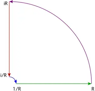

While similar to mrf's answer, this is simplified by equating the real and imaginary parts of $(3)$.
Since there are no singularities inside the contour in the hint, we get $$ \oint\frac{\log(z)}{z^2-1}\mathrm{d}z=0\tag{1} $$ Breaking the countour into four pieces as follows
$\hspace{4.5cm}$enter image description here
$(1)$ and the triangle inequality yield $$ \left|\color{#00A000}{\int_{1/R}^R\frac{\log(x)}{x^2-1}\mathrm{d}x} \color{#C00000}{-\int_{1/R}^R\frac{\log(ix)}{-x^2-1}\mathrm{d}ix}\right| \le\color{#0000FF}{\frac{\log(R)+\pi/2}{1-1/R^2}\frac{\pi}{2R}} +\color{#800080}{\frac{\log(R)+\pi/2}{R^2-1}\frac{\pi R}{2}}\tag{2} $$ which, as $R\to\infty$, guarantees $$ \begin{align} \int_0^\infty\frac{\log(x)}{x^2-1}\mathrm{d}x &=\int_0^\infty\frac{\log(ix)}{-x^2-1}\mathrm{d}ix\\ &=-i\int_0^\infty\frac{\log(x)}{x^2+1}\mathrm{d}x +\frac\pi2\int_0^\infty\frac1{x^2+1}\mathrm{d}x\tag{3} \end{align} $$ By equating the real and imaginary parts in $(3)$, we get not only the desired answer $$ \int_0^\infty\frac{\log(x)}{x^2-1}\mathrm{d}x=\frac{\pi^2}{4}\tag{4} $$ but also $$ \int_0^\infty\frac{\log(x)}{x^2+1}\mathrm{d}x=0\tag{5} $$
robjohn
  • 353,833
  • I didn't get the right side of (2), can you explain this for me? – Mauro Jun 03 '15 at 11:47
    On the blue arc, the triangle inequality says $$\begin{align}|\log(z)| &=|-\log(R)+i\arg(z)|\ &\le\log(R)+\pi/2\end{align}$$ and $$\begin{align}|z^2-1| &\ge1-|z^2|\ &=1-1/R^2\end{align}$$ and the length of the arc is $\dfrac\pi{2R}$. On the purple arc $$\begin{align}|\log(z)| &=|\log(R)+i\arg(z)|\ &\le\log(R)+\pi/2\end{align}$$ and $$\begin{align}|z^2-1| &\ge|z^2|-1\ &=R^2-1\end{align}$$ and the length of the arc is $\dfrac{\pi R}2$. – robjohn Jun 03 '15 at 12:28
