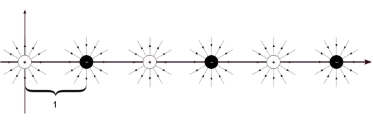

The inspiration comes from a physical problem. Let's focus on the non-negative half of the number axis -- so we are studying a 1D system. We put 1 unit positve charge on "site" 0, then a unit negative charge on site 1, then a unit positive charge on site 2, ... See figure below.
alternating charges
The question is what's the force on the zeroth charge (the left most one). More specifically,
  1. what's the total force if we are considering all the charges. (the infinite sum)
  2. what's the partial force if we are considering forces exerted by the first N charges, here N excludes the 0th charge. (the partial sum)
The physics is just Columb's law. We neglect all physical constants, and since all charges are unit, we have the force expressed as a series
$$ F(N) = \sum_{n=1}^N \frac{(-1)^{n-1}}{n^2} $$
A plot in Mathematica shows $F(100)$ is well converged and is about $0.82242$. But I am sure someone has more elegant analysis. I myself did a lousy approximation by "spreading" a charge into an interval as $$ \frac{\pi}{2} {\cos(\pi x)} $$ $F(N)$ is then approximated by an integration. $$ F(N) \sim -\frac{\pi}{2} \int_{1/2}^{N+1/2} \frac{\cos(\pi x)}{x^2} dx $$ This approximation is very crude and for the infinite sum, it gives $F(\infty) \sim 0.98713$ - not bad, but not good either.
