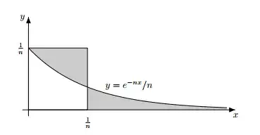

In his gorgeous paper "How to compute $\sum \frac{1}{n^2}$ by solving triangles", Mikael Passare offers this idea for proving $\sum_{n=1}^\infty \frac{1}{n^2} = \frac{\pi^2}{6}$:
Proof of equality of square and curved areas is based on another picture:
Recapitulation of Passare's proof using formulas is as follows: (for each step there is a geometric justification)
$$\sum_{n=1}^\infty \frac{1}{n^2} = \sum_{n=1}^\infty \int_0^\infty \frac{e^{-nx}}{n}\; dx\; = -\int_0^\infty log(1-e^{-x})\; dx\; = \frac{\pi^2}{6}$$
