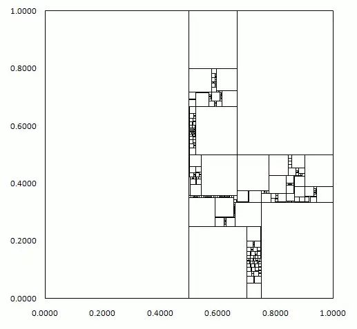

I believe this question is interesting by its own accord. In addition, however, I hope any answers to it might yield insights into a specific problem in discrete geometry. It concerns the question of whether a square can be covered by rectangles of size $\frac{1}{k} \times \frac{1}{k+1} $. One can read more about this problem on the following MO thread.
The problem hasn't been solved yet. Approximate solutions have been generated, however. Below is an example of such an approximation by MO user Ed Wynn:

We see that the connection arises in equation \eqref{5}, as the same terms as the sizes of the rectangles are indicated.
