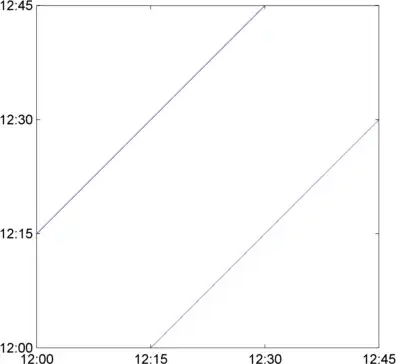

This is a great question to answer graphically. First note that the two can't arrive after 12:45, since they have to spend at least 15 minutes in the bar. Second, note that they meet if their arrival times differ by less than 15 minutes.
If we plot the arrival time of person 1 on the x axis, and person 2 on the y axis, then they meet if the point representing their arrival times is between the two blue lines in the figure below. So we just need to calculate that area, relative to the area of the whole box.
The whole box clearly has area
$$45 \times 45 = 2025$$
The two triangles together have area
$$2\times \tfrac{1}{2} \times 30 \times 30 = 900$$
Therefore the probability of the friends meeting is
$$(2025-900)/2025 = 1125/2025 = 5/9$$

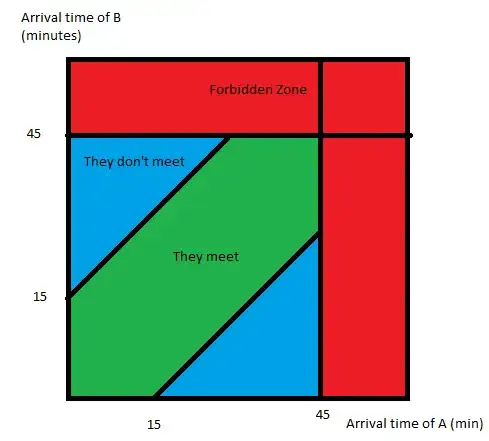

75
solution
$$ \text{chance they meet} = \frac{\text{green area}}{\text{green area + blue area}} = \frac{45^2 - 30^2}{45^2} $$
