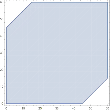

Here is a plot of the starting time in minutes for $x$ (horizontal) and $y$ (vertical) and the cases where they will meet. Formally: $(x,y)\ s.t. |x-y| \leq 45 \wedge 0 \leq x \leq 60 \wedge 0 \leq y \leq 60$.
The area of this region divided by the total possible region is the probability they will meet: $15/16$.
