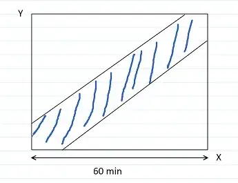

Hint:
We will consider the situation in terms of minutes. We notice that that they will meet only if $|X-Y|\leq 5/60$, where $X,Y$ is the time of arrival as a fraction of the hour. We notice that $X,Y\overset{iid}{\sim} \text{unif(0,1)}$. Then they problem becomes $$P(|X-Y| \leq 5/60).$$ It will help to draw a picture. No integration required.
You can do it considering the $X,Y\overset{iid}\sim\text{unif}(1,60)$ too. enter image description here
Notice that we want the blue part. Also, notice that we can instead consider the complement \begin{align*} P(|X-Y|<5) &= P(-5<X-Y<5)\\ &=P(\text{blue})\\ &= 1-P(\text{Not blue})\\ &= 1-2\bigg[\underbrace{(1/2)\cdot55\cdot55\cdot 60}_{(1)}/\underbrace{60^3}_{(2)}\bigg]\\ &= 1-\left(\frac{55}{60}\right)^2 \\ &= \frac{23}{144} \end{align*}
where in
  1. That is the volume of one wedge
  2. That is the entire volume.
Em.
  • 16,196
  • Can you show how to do it using Integral. Thanks – Gerry May 30 '16 at 13:37
  • No, I specifically did not want to integrate. You are simply going to be finding the volume above the blue strip. You're going to have to break up the blue strip into 3 regions. – Em. May 30 '16 at 13:41
