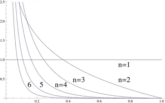

PDF of the Product of Independent Uniform Random Variables
If $[0\le x\le1]$ is the PDF for $X$ and $Y=\log(X)$, then by $(2)$ the PDF of $Y$ is $e^y[y\le0]$. The PDF for the sum of $n$ samples of $Y$ is the $n$-fold convolution of $e^y[y\le0]$ with itself. The Fourier Transform of this $n$-fold convolution is the $n^\text{th}$ power of the Fourier Transform of $e^y[y\le0]$, which is $$ \int_{-\infty}^0 e^{-2\pi iyt}e^y\,\mathrm{d}y=\frac1{1-2\pi it}\tag3 $$ Thus, the PDF for the sum of $n$ samples of $Y$ is $$ \begin{align} \sigma_n(y) &=\int_{-\infty}^\infty\frac{e^{2\pi iyt}}{(1-2\pi it)^n}\,\mathrm{d}t\tag{4a}\\ &=\frac{e^y}{2\pi i}\int_{1-i\infty}^{1+i\infty}\frac{e^{-yz}}{z^n}\,\mathrm{d}z\tag{4b}\\ &=e^y\frac{(-y)^{n-1}}{(n-1)!}\,[y\le0]\tag{4c} \end{align} $$ Explanation:
$\text{(4a)}$: take the inverse Fourier Transform
$\text{(4b)}$: substitute $t=\frac{1-z}{2\pi i}$
$\text{(4c)}$: if $y\gt0$, close the contour on the right half-plane, missing the singularity at $z=0$
$\phantom{\text{(4c):}}$ if $y\le0$, close the contour on the left half-plane, enclosing the singularity at $z=0$
We can get the PDF for the product of $n$ samples of $X$ by applying $(2)$ to $(4)$ $$ \bbox[5px,border:2px solid #C0A000]{\pi_n(x)=\frac{(-\log(x))^{n-1}}{(n-1)!}\,[0\le x\le1]}\tag5 $$ enter image description here
