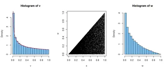

Note: Graphs based on random sample of $m = 50,000$ of $X$ and $Y$ illustrate some of the results. The first panel shows a histogram of $m$ values of $V$ along with the density function of $V \sim \mathsf{Beta}(.5, 1).$ The second panel suggests the bivariate distribution of $(U,W)$ and may help with the limits on the integral required to derive the marginal distribution of $W.$ The third panel shows a histogram of $m$ values of $W,$ roughly suggesting shape of the PDF of $W,$ but not showing it explicitly.
