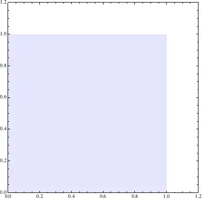

Since there was some confusion about how the limits of integration were obtained, I have included the following diagram:
The horizontal axis represents outcomes of $X$, and the vertical axis represents outcomes of $Y$, so the light blue square represents points $(X,Y)$ that are joint outcomes of both variables. Because we know that $X$, $Y$ are joint uniform random variables on $[0,1] \times [0,1]$, it follows that the probability $\Pr[XY \le z]$ corresponds to the area of the combined red region, which is bounded by a family of hyperbolas of the form $xy = z$ for a constant $z \in [0,1]$. The first method of integration thus requires us to split the red region into two parts; the first is the lighter red rectangle and corresponds to the interval from $x = 0$ to where the hyperbola $y = z/x$ intersects the upper edge of the square $y = 1$; i.e., $x = z$. The second part is the darker red region corresponding to the remaining interval from $x = z$ to $x = 1$.
But if you study the picture, you can see that there is an easier way: the area of the square is constant and equal to 1, so we could have obtained the red area by instead computing the area of its complement--the blue region not covered by the red. This is the second method I describe, which calculates $\Pr[XY > z]$.
