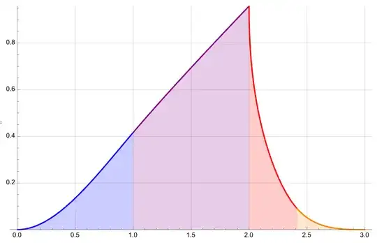

$$f_Z(z) = \begin{cases} \frac{(8-3z)z^2}{12}, & 0 \le z \le 1 \\ \frac{z}{2} - \frac{1}{12z}, & 1 < z \le 2 \\ \frac{z^3}{4} + \frac{2z^2}{3} - \frac{25z}{6} + \frac{14}{3} - \frac{1}{12z} - \frac{4(z-1)\sqrt{z(z-2)}}{3}, & 2 < z \le 1 + \sqrt{2} \\ \frac{(3-z)^3(3z-5)}{12(z-2)}, & 1 + \sqrt{2} < z \le 3. \end{cases}$$
This suggests that the PDF can be calculated via elementary methods, but the full computation would be very tedious. A plot of $f$ is shown below:
