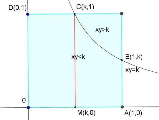

Here is a graphical way to obtain the cdf, then the pdf of RV $Z=XY$ when $X,Y$ are iid RV with $U(0,1)$ distribution.
$(X,Y)$ being a uniformly distributed point in the unit square $[0,1]^2$ (see figure below), the probability, for a fixed $k$, of event ''$XY<k$'' is (see remark below) the area of the corresponding region $OABCD$ delimited by line segments $OA,AB$, an arc of hyperbola $(H_k)$ with equation $y=\frac{k}{x}$ from $B$ to $C$, and line segments $CD$ and $DO$.
This area is easily computable by splitting it into
  • the area of a rectangle (with value $1 \times k$) and
  • the area below the arc of curve $(H_k)$, with value $\int_k^1 \dfrac{k}{x}dx=k [\ln(x)]_k^1=-k \ln k$ (don't forget that $0<k<1$ implies $\ln k < 0$).
Gathering these two values, we obtain the following expression for the cdf of $Z$:
$$F_Z(k):=P(Z<k)=P(XY<k)=k - k \ln k$$
with derivative, its pdf:
$$f_Z(k)=1-k\dfrac{1}{k}-\ln k= -\ln k.$$
Easy, isn't it ?
Remark: A little elementary step has been skipped: strictly speaking, we should have said that this probability is the ratio of the area OABCD to the total area, with a total area equal to $1$...
