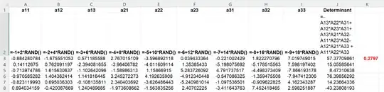

This is just an extended comment that responds to your request for me to justify my suggestion that the answer is closer to 0.274648. I show that is roughly the answer using Excel, R, and Mathematica.
Excel
Excel approach
The 0.2797 is what I get with 10,000 simulations. Cell J3 is
 =-C3*E3*G3+B3*F3*G3+C3*D3*H3-A3*F3*H3-B3*D3*I3+A3*E3*I3Cell K3 is
Cell K3 is
 =(COUNTIF(J3:J10002,">=-9")-COUNTIF(J3:J10002,">9"))/10000
