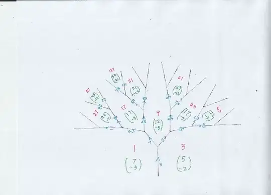

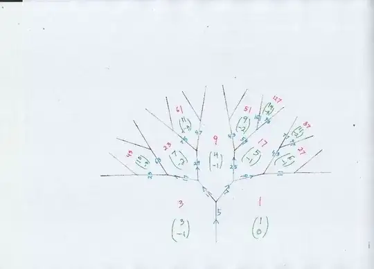

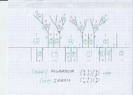

    With prime target, there are two orbits under the form automorphism and its inverse, $$ (x,y) \mapsto (4x+9y, 3x+7y). $$ There is also a single map (involution) of determinant $-1$ here, $(x,y) \mapsto (x+y, -y).$ – Will Jagy Aug 26 '20 at 16:34

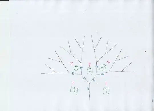

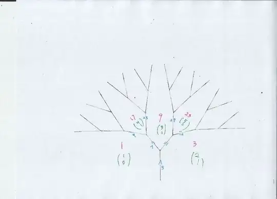

Conway's Topograph, with some artwork improvements of mine. I found that I really wanted to draw the "river" as a straight line. When there is not really enough room to draw in the representations of a number (17) I realized that drawing a separate (rooted) tree as though growing from the river allowed for a more legible rendition of that number representation. For that matter, while correctly drawing the river alternates among Conway's rules, once one of these trees is correctly begun, it is just one small collection of rules to expand it outward. Now that I think of it, there are intricate rules about the direction of the little blue arrows along the river, but in a tree they all go the same way, away from the tree root when the pink values in the tree are positive. The really big item was simply that the generator of the automorphism group, which is a 2 by 2 matrix, appears as explicit columns (in green) in the diagram. Let's see, I don't know any book that consistently draws in all of Conway's numbers, all of which have meaning; I started using four colors once I saw the legibility problems.
Oh, forgot this part. From the automorphism matrix, Cayley-Hamilton says that we get two $x$ orbits and two $y$ orbits, trace is $11$ so each is $$ x_{n+2 } = 11 x_{n+1} - x_n $$ $$ y_{n+2 } = 11 y_{n+1} - y_n $$ One orbit of pairs is $$ 19,4,25,271,...$$ $$ -8,1,19,208...$$ The other orbit of pairs $$ 5, 11, 116, 1265, ... $$ $$ -1,8, 89, 971, ... $$
Since there is a mixed $xy$ term in this one, the orbits should be extended backwards as well as forwards. One way to write that is
$$ x_n = 11 x_{n+1} - x_{n+2} $$ $$ y_n = 11 y_{n+1} - y_{n+2} $$
