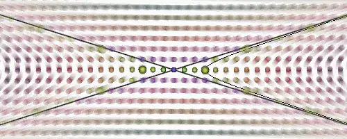

One loop of this hypnotic animation represents one application of the function $f$. Each dot corresponds to one point of the plane with integer coordinates, and is moved to its image by $f$ in the course of the loop. The points are colored according to their norm (and as you can see, each of them stay on their hyperbolic branch of points sharing their norm), and I've made the yellow-ish points of norm 9 (the solutions of $x^2-10y^2 = 9$) a bit bigger. For example, the point at (3,0) is sent outside the graph, and the point at (-7,2) is sent on (13,4) (almost vanishing).
You can see that there are three points going through (3,0) during the course of one loop. They correspond to three representants of the three fundamental solutions of the equation. For each yellowish point on the curve $x^2-10y^2=9$, no matter how far along the asymptote it may be, there is an iterate of $f$ or $f^{-1}$ that sends it to one of those three fundamental solutions.
In order to find all fundamental solutions, it is enough to explore only a fundamental portion of the curve (a portion whose iterates by $f$ covers the curve), for example the fundamental portion of the curve between (-7,2) and its image by $f$, (13,4). To find the solutions on that portion, you set $y=-2,-1,0,1,2,3$ and look if there is an integer $x$ that makes a solution for each of those $y$.
Whichever fundamental portion of the curve you choose, you will find 3 solutions inside it, whose images by $f$ are sent to the next three solutions in the next portion of the curve, and so on.

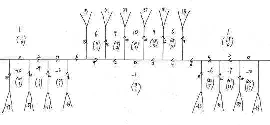

Full cycle: Conway's method has some little tweaks compared to Lagrange/Gauss/Eisenstein. I think what I will do, since I do not know how to post the diagram [now added below], is just to put all the equivalent forms along the "river," always taking the first component positive (disagrees with Gauss) and always taking the equivalence matrix to have positive determinant. With these conventions, it is necessary to take some of the forms with negative middle coefficient. It's a lifestyle choice. I try not to judge.
 Will Drawing
So, when I say $\langle 1, 0, -10 \rangle $ is equivalent to $\langle 9, 2, -1 \rangle $ with matrix $A \in SL_2 \mathbf Z$ given by $$ A \; = \; \left( \begin{array}{cc} 7 & 3 \\ 2 & 1 \end{array} \right), $$ this means that $A$ is on the right and $$ \left( \begin{array}{cc} 7 & 2 \\ 3 & 1 \end{array} \right) \left( \begin{array}{cc} 1 & 0 \\ 0 & -10 \end{array} \right) \left( \begin{array}{cc} 7 & 3 \\ 2 & 1 \end{array} \right) = \left( \begin{array}{cc} 9 & 1 \\ 1 & -1 \end{array} \right). $$ When I say $\langle 1, 0, -10 \rangle $ is equivalent to $\langle 9, -2, -1 \rangle $ with matrix $A \in SL_2 \mathbf Z$ given by $$ A \; = \; \left( \begin{array}{cc} 13 & 3 \\ 4 & 1 \end{array} \right), $$ this means that $A$ is on the right and $$ \left( \begin{array}{cc} 13 & 4 \\ 3 & 1 \end{array} \right) \left( \begin{array}{cc} 1 & 0 \\ 0 & -10 \end{array} \right) \left( \begin{array}{cc} 13 & 3 \\ 4 & 1 \end{array} \right) = \left( \begin{array}{cc} 9 & -1 \\ -1 & -1 \end{array} \right). $$
With those in mind, a full cycle along Conway's river is $$\langle 1, 0, -10 \rangle, \left( \begin{array}{cc} 1 & 0 \\ 0 & 1 \end{array} \right), $$
$$\langle 1, 2, -9 \rangle, \left( \begin{array}{cc} 1 & 1 \\ 0 & 1 \end{array} \right), $$
$$\langle 1, 4, -6 \rangle, \left( \begin{array}{cc} 1 & 2 \\ 0 & 1 \end{array} \right), $$
$$\langle 1, 6, -1 \rangle, \left( \begin{array}{cc} 1 & 3 \\ 0 & 1 \end{array} \right), $$
$$\langle 6, 4, -1 \rangle, \left( \begin{array}{cc} 4 & 3 \\ 1 & 1 \end{array} \right), $$
$$\langle 9, 2, -1 \rangle, \left( \begin{array}{cc} 7 & 3 \\ 2 & 1 \end{array} \right), $$
$$\langle 10, 0, -1 \rangle, \left( \begin{array}{cc} 10 & 3 \\ 3 & 1 \end{array} \right), $$
$$\langle 9, -2, -1 \rangle, \left( \begin{array}{cc} 13 & 3 \\ 4 & 1 \end{array} \right), $$
$$\langle 6, -4, -1 \rangle, \left( \begin{array}{cc} 16 & 3 \\ 5 & 1 \end{array} \right), $$
$$\langle 1, -6, -1 \rangle, \left( \begin{array}{cc} 19 & 3 \\ 6 & 1 \end{array} \right), $$
$$\langle 1, -4, -6 \rangle, \left( \begin{array}{cc} 19 & 22 \\ 6 & 7 \end{array} \right), $$
$$\langle 1, -2, -9 \rangle, \left( \begin{array}{cc} 19 & 41 \\ 6 & 13 \end{array} \right), $$
$$\langle 1, 0, -10 \rangle, \left( \begin{array}{cc} 19 & 60 \\ 6 & 19 \end{array} \right). $$
Various items, already mentioned. The first "automorph" is then $$ \left( \begin{array}{cc} 19 & 60 \\ 6 & 19 \end{array} \right). $$ The forms with negative middle coefficient are precisely those edges that point to the left. We switch from altering the first column to altering the second column, or back, precisely at the "reduced" forms, which in this case are only $\langle 1, 6, -1 \rangle$ and $\langle -1, 6, 1 \rangle,$ where we have written the latter as $\langle 1, -6, -1 \rangle$ to stick with beginning with a positive coefficient. Finally, there was no need to stray away from the river for this problem, $9$ is just small enough to spare us that extra complication.
Will Jagy
