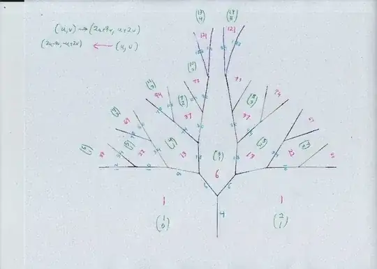

A full accounting of all $(u,v)$ pairs is given by combining the $(2u+3v, u + 2 v)$ formula with the Conway topograph.
Here are some answers with the topograph , then two books that talk about it:

I'm afraid I was not able to fit this entire diagram onto one page. However, combine this with How to find solutions of $x^2-3y^2=-2$? and you get all integer expressions for $u^2 - 3 v^2 = 121,$ which then lead to all $a^2 + 4ab + b^2 = 121.$
All solutions $(u,v)$ come from the transformation $(2u+3v, u + 2 v),$ its inverse $(2u-3v, -u + 2 v),$ and the three triples $$ (11,0), (13,4),(14,5) $$ Some care is need for the original $(a,b)$ problem because the change of variables does not quite keep positivity. Indeed, instead of the $\pm$ symmetries, the original variables have $(a,b)$ going to $(b,a).$
