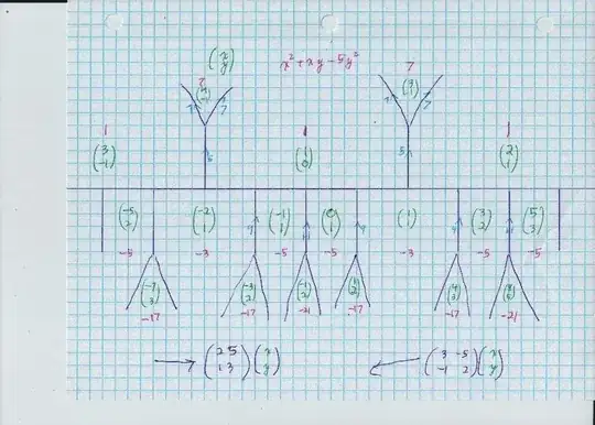

So, to get fewer orbits with the nicer recursion: we get $$ y_{k+2} = 5 y_{k+1} - y_k $$ in two threads $$ 1, 3, 14, 67, 321, 1538, 7369,... $$ $$ 2, 9, 43, 206, 987, 4729, 22658,... $$ A really careful proof of this is a Conway Topograph, which is easy enough for this problem that I will probably draw it and post it here.

jagy@phobeusjunior:~$
