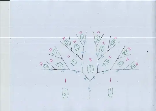

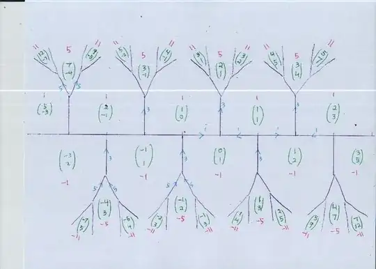

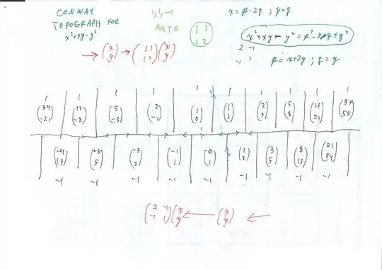

It turns out I have a diagram of Conway's topograph pdf for this. The very simple statement is that "the river is periodic." This means that, if we can find all solutions within one period, we have them all.
Recent book by Allen Hatcher pdf
ALSO: Recent book at a fairly elementary level: Weissman
Broken down further, it means that any solution to $a^2 + ab - b^2 = 1$ leads to another, $$ (a,b) \mapsto (a+b, a + 2b) $$ As you can see from the (vertical) vectors when the form value is $1,$ this makes $a,b$ consecutive Fibonacci, by induction.
As you can see, I draw in little $(x,y)$ "coordinate" pairs as column vectors. This is crucial for my approach; the other two books do not really push this aspect, but it is done well in Stillwell, Elements of Number Theory.
I have drawn a portion of the river, with colors as in the tree diagrams, and showing the relative positions of the values $11.$ I have worked out how to force the given mapping $ (a,b) \mapsto (a+b, a + 2b) $ as we move to the right, or $ (a,b) \mapsto (2a-b, -a + b) $ as we move to the left.

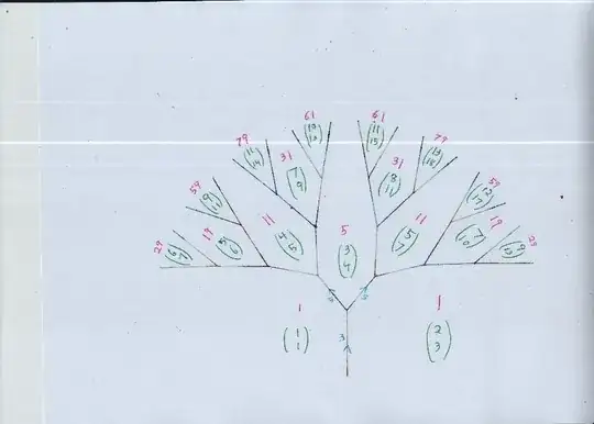

There was a question in comment about $a^2 + ab - b^2 = 11.$ It is enough to draw a single "tree" of positive values climbing away from the river. We see $11$ as $(a,b)$ pairs $(3,1)$ and $(3,2).$ All other solutions with positive $(a,b)$ occur in other trees along the river. They can be found with $ (a,b) \mapsto (a+b, a + 2b) .$ In the next tree to the right, we get $(4,5)$ and $(5,7).$ A second tree to the right, we get $(9,14)$ and $(12,19).$ Also, Cayley-Hamilton says that we get two orbits under a pair of linear degree two recurrences, $$ a_{n+2} = 3 a_{n+1} - a_n, $$ $$ b_{n+2} = 3 b_{n+1} - b_n. $$ I wrote out a simple proof without using Cayley-Hamilton at How does one solve this recurrence relation?
Alright, I did one tree over, I mostly left off the blue edge labels, which match the previous tree.

  • Thank you for the illustration, but I just wonder, doesn't the math behind Conway's topograph require essentially the same advanced abstract algebra methods that Qiaochu Yuan mentioned in his answer above? I don't believe that an automorphism group is a concept that a high school student or a 17th century mathematician could comprehend. – Geoffrey Caveney Dec 03 '17 at 19:47
  • Also, are you sure that this method proves the impossibility of other solutions in other sequences? For example, let's say I claimed all solutions of (b-a)(b+a) = ab - 11 were in the sequence 1,4,5,9,14,23,37,60,.... As in your method, induction shows that each solution in the sequence leads to another. But in fact in this case there is a different sequence with solutions: 2,5,7,12,19,31,50,.... Can your method identify both sequences? How? – Geoffrey Caveney Dec 03 '17 at 20:05
  • @GeoffreyCaveney yes, I'm sure. When you switch to a prime, in your case $11,$ you expect two orbits. Forget the word automorphism. It is just an explicit integer mapping that takes locations in the topograph to others with the same quadratic form. Recommend you learn the method, here is Conway's original http://www.maths.ed.ac.uk/~aar/papers/conwaysens.pdf – Will Jagy Dec 03 '17 at 20:13
  • @GeoffreyCaveney added links to some topograph answers. Recommend you learn how to draw them. Also, given your concerns, suggest you look at http://math.stackexchange.com/questions/739752/how-to-solve-binary-form-ax2bxycy2-m-for-integer-and-rational-x-y/739765#739765 where, because $55$ is composite, there are several orbits; these are readily found in the "trees" I draw. – Will Jagy Dec 03 '17 at 20:19
  • The Conway monograph is very interesting, thank you Will. I will look into it and your examples further. – Geoffrey Caveney Dec 03 '17 at 20:22
  • @GeoffreyCaveney I added that the business of drawing in (x,y) column vector "coordinates" is dealt with best in Stillwell's book, Elements of Number Theory. You will see, I had to be very careful about the dimensions and spacing of my diagrams, to fit in all the types of numerical labels. However, combining periodicity of the river and The Climbing Lemma, finding all solutions of "form equals target number" is just very careful drawing and labelling of diagrams. – Will Jagy Dec 03 '17 at 20:32
