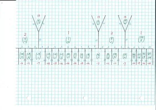

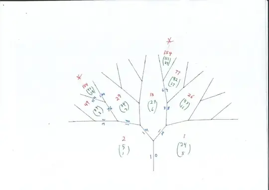

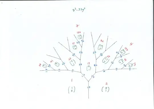

I decided to draw the complete diagram of the Conway topograph, first the river, then the two extensions (trees) away from the river that, together, give all orbits for representing $x^2 - 23 y^2 = 154,$ those four seed pairs being $$ (19,3); \; (27,5); \; (73,15); \; (111,23). $$
As far as the original posted problem, the seeds for representing $x^2 - 23 y^2 = -11$ all occur along the river. Note that, as $x^2 - 23 y^2 \equiv x^2 + y^2 \pmod 4,$ whenever $x^2 - 23 y^2 \equiv 0 \pmod 4,$ it follows that both $x,y$ are even. That is, the seeds for $-11$ are $$ (9,2); \; (14,3), $$ therefore the only seeds for $-44$ are $$ (18,4); \; (28,6). $$
You can see Ross's formula $(24x+115y, 5x+24y)$ at the far right of the river diagram, on graph paper. We see a representation of $1$ with column vector $(24,5)^T,$ below it and all the way to the edge of the paper, a representation of $-23$ with column vector $(115,24)^T.$ Put them side by side and we get the two by two matrix $$ \left( \begin{array}{cc} 24 & 115 \\ 5 & 24 \end{array} \right) $$ of determinant $+1.$ That matrix, applied to a column vector $(x,y)^T,$ gives Ross's mapping.
I used a pink pen for the represented numbers in the two tree diagrams, it is a bit hard to read; next time, always red for the represented numbers.
I put four explanatory documents at OTHER with prefix indefinite_binary. For that matter, Conway's entire book is available at PDF
