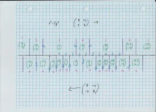

Don't know about your script. I checked with a Conway topograph, you do have all the necessary "seed" solutions. Also, because we can negate either $x$ or $y$ as wished, we do not need to add in negative solutions. So, given any solution $x^2 - 7 y^2 = -3,$ you get a new solution with $$ (x,y) \mapsto (8x+21y, \; \; 3x+8y). $$ We get two orbits under the oriented automorphism group, $$ (-5,2), $$ $$ (2,1), $$ $$ (37,14), $$ $$ (590,223), $$ $$ (9403,3554), $$ und so weiter. Then $$ (-2,1), $$ $$ (5,2), $$ $$ (82,31), $$ $$ (1307,494), $$ $$ (20830,7873), $$
The other description, for either one of the two strings of solutions, is $$ x_{n+2} = 16 x_{n+1} - x_n, $$ $$ y_{n+2} = 16 y_{n+1} - y_n. $$ For example $16 \cdot 5 - (-2) = 82.$ Or $16 \cdot 82 -5 = 1307.$ Also $16 \cdot 2 -1 = 31$
Here is the diagram, all that is necessary for this problem.
Since I forgot that I had written programs to get the diagram right and correct any arithmetic errors i might make, let me record the relevant part of the output below. The output is the diagram rotated by $90^\circ$
 ./Conway_Topograph_Pointed 1 0 -7 > Conway_1_0_-7.txt
            8   -21           -7    0    1           -3     8
   14
            5   -13           -6    2    1           -3     8
   10
            2    -5           -3    4    1           -3     8
            2    -5           -3   -2    2           -1     3
    8
            1    -2           -3    2    2           -1     3
            1    -2           -3   -4    1            0     1
   10
            1    -1           -6   -2    1            0     1
   14
            1     0           -7    0    1            0     1
   14
            1     1           -6    2    1            0     1
   10
            1     2           -3    4    1            0     1
            1     2           -3   -2    2            1     3
    8
            2     5           -3    2    2            1     3
            2     5           -3   -4    1            3     8
   10
            5    13           -6   -2    1            3     8
   14
            8    21           -7    0    1            3     8
