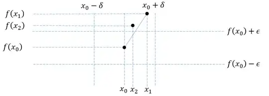

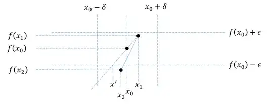

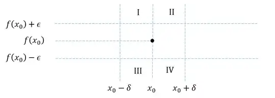

You can do a proof by contradiction.
Assume $f\in\mathbb{R}^\mathbb{R}$ is convex, but not continuous at some $x_0\in(a,b)$. This means that: $$ \exists_{\epsilon>0}\forall_{\delta>0}\exists_{x\in(x_0-\delta,x_0+\delta)} : |f(x)-f(x_0)|\ge\epsilon$$ This formula implies that once we fix $\delta$, $f$'s graph has infinitely many points in one of the areas: I, II, III or IV, with $x_0$ as an accumulation point of their $x$ coordinates:
We split our proof into 2 cases:
$(1)$ The area is either I or II. In this case we select some point on the function's graph from that area: $(x_1,f(x_1))$, and draw a line segment from that point to $(x_0,f(x_0))$. We then select another point on the graph from the same area: $(x_2,f(x_2))$, whose $x$ coordinate is closer to $x_0$ than the intersection of our line segment and $y=f(x_0)+\epsilon$ . This contradicts the convexity of $f$, as can be seen in the following image: enter image description here
$(2)$ The area is either III or IV. Assume, without loss of generality, that the area is III. In this case we select some point on the function's graph to the right of $x_0$, say: $(x_1,f(x_1))$. We then draw a ray, which starts at $(x_1,f(x_1))$, and goes through $(x_0,f(x_0))$. We use $x'$ to denote the $x$ coordinate of the intersection of our ray and $y=f(x_0)-\epsilon$. If they do not intersect, we set: $x'=-\infty$. Next, we select another point: $(x_2, f(x_2))$ on $f$'s graph, in area III, with $x'<x_2<x_0$. Finally, we draw a segment between $(x_2, f(x_2))$ and $(x_1, f(x_1))$. This again contradicts convexity, as can be seen in the following image: enter image description here
