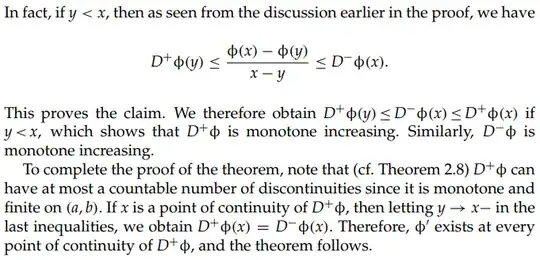

If $\phi$ is finite and convex in $(a, b)$, then $\phi$ is continuous in $(a, b)$. Moreover, $\phi'$ exists except at most in a countable set and is monotone increasing.
Theorem 2.8 Every function of bounded variation has at most a countable number of discontinuities, and they are all of the first kind (jump or removable discontinuities).

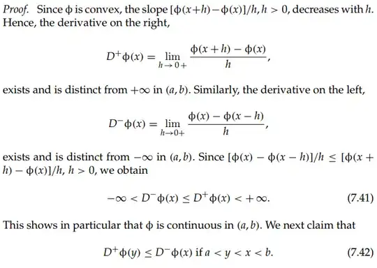

  • How does $(7.41)$ show in particular that $\phi$ is continuous in $(a,b)$? Don't we need to show $D^-\phi(x) = D^+\phi(x)$ as $h\to 0+$? The book shows $D^-\phi(x) = D^+\phi(x)$ at the end of the proof.
user398843
  • 1,831
  • @mfl This is Theorem 7.40 on page 157 of Measure and integral by Wheeden and Zygmund. The theorem on page 157 doesn't state that $\phi$ is finite, but since they say $D^+\phi$ is of bounded variation I looked up the beginning of this section on page 154, and they suppose $\phi$ is finite on an open interval $(a,b)$. Also see the comment by Michael Grant on this post https://math.stackexchange.com/q/258511/426645. – user398843 Aug 10 '18 at 22:32
  • @mfl The interval here is open, the one in the counterexample is compact, and the compactness plays a role there. – amsmath Aug 10 '18 at 22:37
The existence of the limit $D^+\phi(x)$ tells us in particular that $\phi(x+h)\to\phi(x)$ as $h\to 0+$. Similarly, the existence of $D^-\phi(x)$ implies $\phi(x-h)\to\phi(x)$ as $h\to 0+$. These together yield that $\phi$ is continuous at $x$.
