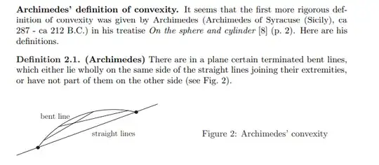

I found Roman J. Dwilewicz's A short history of convexity, which provides some important notes on the history of convexity in mathematics. For instance, the famous Greek philosopher Archimedes first made some observations on Convexity:

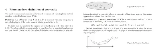

Convexity was further defined by mathematicians such as Cauchy and Euler, until we developed some of the more familiar definitions of Convexity:

  • Please provide the source of the screenshots – Rodrigo de Azevedo May 30 '23 at 17:33
