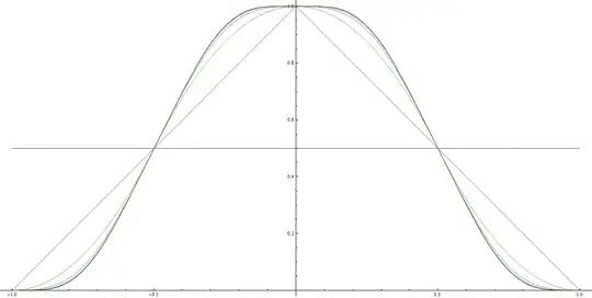

$$ f_0(x) = \begin{cases} 1/2 & |x|<1 \\ 0 & |x|\geq1 \end{cases} \\ f_n(x) = 2\int_{-1}^x(f_{n-1}(2t+1)-f_{n-1}(2t-1))\mathrm{d}t $$ It's very clear that this converges against some function and that quite rapidly, as seen in this image, showing the first 8 terms: first 8 functions of the given recursion. Degrees 0 to 7

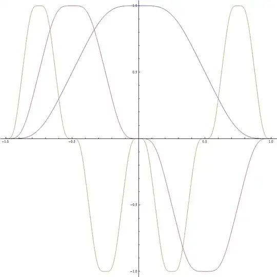

Furthermore, the derivatives of it have some very special properties.
Note how the (renormalized) derivatives consist of repeated and rescaled functions of the previous degree which is obviously a result of the definition of the recursive integral:
Degree 7 function, along with first and second derivative, each normalized to have same magnitude.

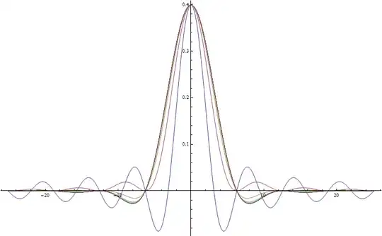

Here an image of how that looks like (first 10 terms in Interval $[-8\pi,8\pi]$):
Fourierspectrum of first 10 terms

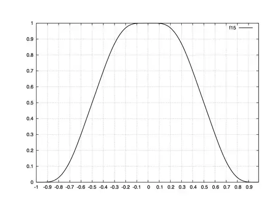

Here is a plot of $f_{15}$ using this formula:
f15

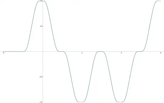

My function $f_n\left(x\right)$ is then just Fabius[n, x+1]. It also extends the function beyond 1:
Plot[Fabius[3, x + 1], {x, -2, 6}, PlotRange -> {-1, 1}]
Fabius function shifted to the left is exactly my function
and the nth derivative is, I believe, just going to be 2^n Fabius[2^n (x+1)].
