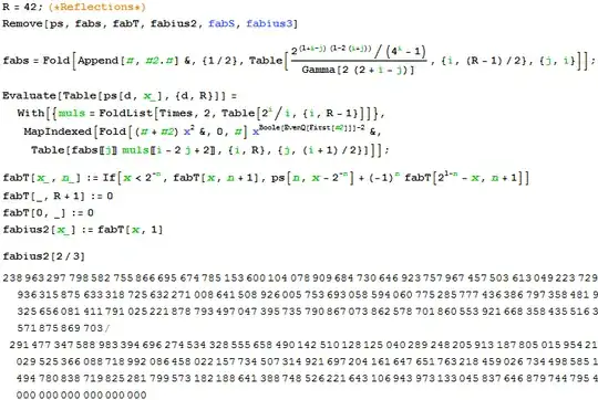

Now that you know $P_i(h)$ for however many $i$s you'd like, you can approximate the value of $F(z)$ for any $z\in[0,1]$ by reflecting the $z$-value about the relevant symmetry-axes among $x=1/2$, $x=1/4$, $x=1/8$, etc. while solving the relevant $P_i(h)$-equation in terms of another Fabius function value which converge super fast towards 0, if you reflect your $z$ towards $x=0$.

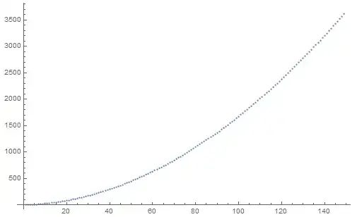

On runtime the needed operations increases quadratically w.r.t. amount of reflections. Using the method for $z=2/3$ causes the need of a reflection about all of the axes because it's binary representation is $0.101010101$... That makes it a good choice to see the significant figures relative to the amount of reflections, which looks very much like a quadratic function as well:
In case anyone is interested, I created the method in Mathematica:

4I re-posted the Mathematica code from the screenshot in plain text format here. – Vladimir Reshetnikov Feb 12 '17 at 01:31
