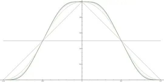

Along with all the other nice answers, I'd like to also mention Exporational B-Splines (ERBSs) which, as I understand it, are a direct generalization of B-Splines to the infinite degree case:
https://www2.isye.gatech.edu/~brani/wp/ExpoSplines.pdf
They have a number of nice properties that are like the "smooth" versions of b-splines
The archetypical version of this is
$$ \frac{\int_{-1}^{x} e^{-\frac{t^2}{1-t^2}} dt}{\int_{-1}^{1} e^{-\frac{t^2}{1-t^2}} dt} $$
but the paper features an extension by several parameters to modify the shape in complicated ways.
Further extensions to the equivalent of NURBS (Non-Uniform Exporational B-Splines, NUERBS) or with knot multiplicities that are not infinite (Generalized Exporational B-Splines, GERBS) also exist
