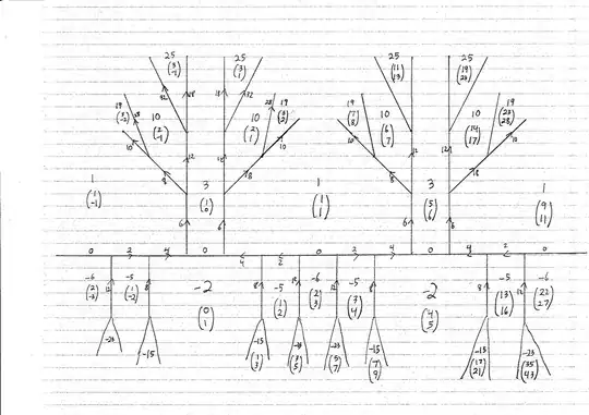

I give an example of Conway's "river" method, including the necessary diagram, at Another quadratic Diophantine equation: How do I proceed?
I recently purchased a home scanner, it does just one page at a time but fairly well. Here, with any luck, is Conway's "River" diagram for this problem: enter image description here
Good, it is there and clear. Note how the ways to express $1$ stay close to the river, and there is just one way per cycle. I have written in the $x,y$ values for each $3x^2 - 2 y^2 = n$ as a column vector in that position. In comparison, if I wanted $3x^2 - 2y^2 = 25,$ i would have several solutions per cycle, for two reasons: for any solution of $3x^2 - 2y^2 = 1,$ I could just multiply through by $5,$ giving one imprimitive solution per cycle. There are also two primitive solutions per cycle, beginning with the two $3 \cdot 3^2 - 2 \cdot 1^2 = 3 \cdot 11^2 - 2 \cdot 13^2 = 25.$
In case it was not clear, the business with automorphs works along with the river construction, all that is really needed is correct identification of the solutions in a single cycle. So, all solutions to $3x^2 - 2 y^2 = 25$ are $$ \pm A^n \cdot \left( \begin{array}{r} 5 \\ 5 \end{array} \right), \; \; \; \pm A^n \cdot \left( \begin{array}{r} 3 \\ 1 \end{array} \right), \; \; \; \pm A^n \cdot \left( \begin{array}{r} 11 \\ 13 \end{array} \right), $$ with $n \in \mathbb Z.$
In case this makes any sense, this diagram is a small section of a parametrization of $PSL_2 \mathbb Z.$ All the solutions we give have $x \geq 0.$ You get the other solutions by negating both $x,y.$ Well, pages 1-33 in Conway's book.
