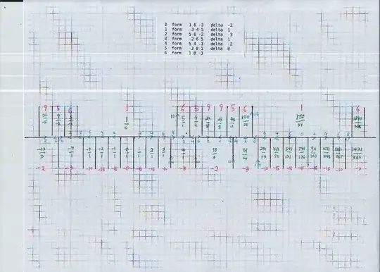

not sure what would satisfy you as "algebraic," however, Conway's topograph method, done with full detail (more than shown in his book) the way I have been drawing the diagram on this site, puts all sorts of numbers and labels on a drawing of $PSL_2 \mathbb Z.$ The construction of $u^2 - d v^2 = 1$ is incorporated into finding the matrix $$ P = \left( \begin{array}{rr} u & dv \\ v & u \end{array} \right) $$ which generates the (oriented) automorphism group of $$ G = \left( \begin{array}{rr} 1 & 0 \\ 0 & -d \end{array} \right), $$ that is $$ P^T G P = G. $$
The example in Hatcher is 19, $$ \left( \begin{array}{rr} 170 & 39 \\ 741 & 170 \end{array} \right) \left( \begin{array}{rr} 1 & 0 \\ 0 & -19 \end{array} \right) \left( \begin{array}{rr} 170 & 741 \\ 39 & 170 \end{array} \right) = \left( \begin{array}{rr} 1 & 0 \\ 0 & -19 \end{array} \right). $$ enter image description here My scanner makes strange colors out of graph paper. That's life. The cycle of length six forms are the Gauss-Lagrange "reduced" forms equivalent to $x^2 - 19 y^2.$ I made a point of including the light blue numerical labels so that you could see where the reduced forms occur in the diagram. A form $\langle A,B,C \rangle$ is a pink value $A,$ a blue edge number $B$ (always positive, the little blue arrow indicates a sort of orientation) then a pink value $C,$ such that $AC < 0$ and $B > |A+C|.$ The fact that this description is equivalent to the usual definition of "reduced" is on page 37 of Franz's 2010 book, Theorem 1.36. enter image description here
