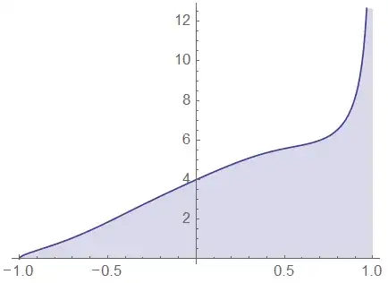

The integrand graph looks like this:
$\hspace{1in}$The integrand graph

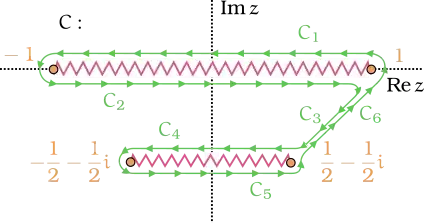

NEW ANSWER. I found yet another way of solving this problem. My new solution does not use contour integration, and is based on the following observation: for $|z| \leq 1$,
$$ - \int_{-1}^{1} \frac{1}{x} \sqrt{\frac{1+x}{1-x}} \log(1 - zx) \, dz= \pi \sin^{-1} z - \pi \log \left( \tfrac{1}{2}+\tfrac{1}{2}\sqrt{1-z^{2}} \right) . $$
As I want to keep both the old answer and the new answer, I posted my new solution to other page. You can check it here.

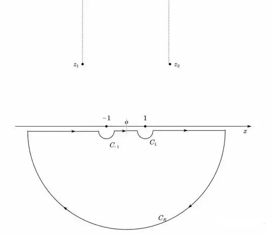

Step 3. (Residue calculation) Since
$$ f(z) := \left( \frac{p'(z)}{p(z)} + \frac{p'(-z)}{p(-z)} \right) \log z = O\left(\frac{\log z}{z^{2}} \right) \quad \text{as } z \to \infty, $$
by replacing the contour of integration by a semicircle of sufficiently large radius, it follows that
\begin{align*} I(r, s) = - \frac{1}{2} \Re \left\{ 2 \pi i \sum_{z_{0} \in \Bbb{H}} \operatorname{Res}_{z = z_{0}} f(z) \right\} = \pi \Im \sum_{z_{0} \in \Bbb{H}} \operatorname{Res}_{z = z_{0}} f(z). \end{align*}
(It turns out that $f(z)$ has only logarithmic singularity at the origin. So it does not account for the value of $I(r, s)$.) But by a simple calculation, together with the condition $ 0 < \alpha < \beta < \frac{\pi}{2}$, we easily notice that the zeros of $p(z)$ are exactly
$$ e^{\pm i(\alpha + \beta)} \quad \text{and} \quad -e^{\pm i(\alpha - \beta)}. $$

Well, 9 years later, this answer is going to utilize an approach via a contour integral. Denote $$I = \int_{-1}^{1} \frac{1}{x} \sqrt{\frac{1+x}{1-x}} \ln \left(\frac{2x^2+2x+1}{2x^2-2x+1}\right) \,\mathrm{d}x \in \mathbb{R}$$ our integral of interest.
Complex function
Let $$f(z) = \frac{1}{z} \sqrt{\frac{z+1}{z-1}}\left(\ln \left({\frac{2z+1+i}{2z-1+i}}\right) + \frac{\pi i}{2}\right),$$ where $\sqrt{w}$ and $\ln w$ are chosen such that they have a branch cut at the negative real axis (the so-called principal branches) in $w$-plane, that is $\arg w \in \left(-\pi,\pi\right]$. We denote $$h(z) = \frac{1}{z} \sqrt{\frac{z+1}{z-1}}, \qquad g(z) = \ln \left({\frac{2z+1+i}{2z-1+i}}\right) + \frac{\pi i}{2}$$ so $f(z) = h(z)g(z)$. To find the branch cuts of $f(z)$, we need to find which points on the $z$-plane are mapped onto the negative real axis in $w$. That is to solve
$$ \boxed{\sqrt{w}}_{B.C.}:\quad w=\frac{z+1}{z-1} = -t,\qquad t>0; \qquad\qquad \boxed{\ln w}_{B.C.}:\quad w=\frac{2z+1+i}{2z-1+i} = -t, \qquad t>0.$$ After simple manipulations, we arrive at $$ \boxed{h(z)}_{B.C.}:\quad z=\frac{t-1}{t+1} \in (-1,1); \qquad\qquad \boxed{g(z)}_{B.C.}:\quad z = \frac{t-1}{2(t+1)} - \frac{i}{2} \in \left(\frac{-1-i}{2},\frac{1-i}{2}\right).$$ where $(z_1,z_2)$ means here a line segment from $z_1$ to $z_2$ for any in general complex $z_1,z_2$.
Poles and residues
At $z\to \infty$, we have $f(z) = \frac{\pi i}{2z} + O(1/z^2)$, a simple pole. So $$\operatorname{Res}_\infty f(z) = - \lim_{z\to\infty} z f(z) = - \frac{\pi i}{2}.$$ Note that there is no pole at $z=0$ since $$\frac{2z+1+i}{2z-1+i} = -i-2iz+O(z^2),$$ so $$g(z) = -\frac{\pi i}{2}+2z + \frac{\pi i}{2} +O(z^2) = 2z +O(z^2),$$ which cancels the simple pole of $h(z)$ at $0 \pm 0i$.
Branch jumps
  • $(-1,1):$ Let $t \in (-1,1)$. Since the complex square root function changes sign on the branch discontinuity, $h(t+i0) = -h(t-i0)$ and so $f(t+i0) = -f(t-i0)$.
  • $\left(\frac{-1-i}{2},\frac{1-i}{2}\right):$ Let $t \in (-1/2,1/2)$. For $z = t - 1/2 i \pm i0,$ $$ \frac{2z+1+i}{2z-1+i} \bigg{|}_{t - i/2 \pm i0} = -r + \left(\frac{2z+1+i}{2z-1+i}\right)' \bigg{|}_{t - i/2} (\pm i0) = - r - \frac{4}{(1-2t)^2} (\pm i 0) = -r \mp i0.$$ where $-r$ is some negative number (branch cut mapped on negative numbers $-r$). Hence, $$g(t+i0) - g(t-i0) = \ln(-r-i0)-\ln(-r+i0) = -2\pi i.$$
Residue theorem
We integrate $f(z)$ along contour $C$ defined in Figure below. The contour is also split as $C = C_1 + \ldots + C_6$.
Contour of integration
According to the Residue theorem, $$\oint_C f(z) \, \mathrm{d}x = - 2\pi i \operatorname{Res}_\infty f(z) = -\pi^2.$$
On the other hand, $$ \oint_C f(z) \, \mathrm{d}z = \sum_{k=1}^6 \int_{C_k} f(z) \, \mathrm{d}z. \tag{1}$$
Parametrisation
For $C_1, \ldots C_6$, we have the following parametrisation:
  • $ \circleddash C_1: z = t + i0, t\in (-1,1), dz = dt$; Since $h(z)$ has a branch cut here, $f(t+i0) = h(t+i0)g(t)$. To obtain $h(t+i0)$, we first compute $$ \frac{z+1}{z-1}\bigg{|}_{t+i0} = \frac{z+1}{z-1}\bigg{|}_{t}+\left(\frac{z+1}{z-1}\right)'\bigg{|}_{t} i0 = -\frac{1+t}{1-t} - \frac{2}{(1-t)^2}i0 = -\frac{1+t}{1-t}-i0,$$ so $h(t+i0) = -\frac{i}{t} \sqrt{\frac{1+t}{1-t}}$. For $g(z)$, we can write $$ g(t) = \ln\left|\frac{2t+1+i}{2t-1+i}\right| + \arg\left(\frac{2t+1+i}{2t-1+i}\right) + \frac{\pi i}{2} = \frac12 \ln\left(\frac{2t^2+2t+1}{2t^2-2t+1}\right) + i \xi(t)$$ for some real function $\xi(t)$ which vanishes at $t=0$. Although we don't need this function, we express it anyway for completeness: Since $-\pi < \arg(2t+1+i)-\arg (2t-1+i) < \pi$, we have $\arg\left(\frac{2t+1+i}{2t-1+i}\right) = \arg(2t+1+i)-\arg (2t-1+i)$ and so $$ \xi(t) = \arctan\left(2t-1\right)-\arctan\left(2t+1\right) + \frac{\pi}{2}.$$ Overall, $$ f(t+i0) = - \frac{i}{t}\sqrt{\frac{1+t}{1-t}} \left( \frac12 \ln\left(\frac{2t^2+2t+1}{2t^2-2t+1}\right) + i \xi(t) \right) .$$ Hence $$ \int_{C_1} f(z) \, \mathrm{d}z = -\int_{\circleddash C_1} f(z) \, \mathrm{d}z = - \int_{-1}^{1} f(t+i0) \, \mathrm{d}t = \frac{i}{2}I - I_0,$$ where we denote $$I_0 = \int_{-1}^{1} \frac{\xi(t)}{t}\sqrt{\frac{1+t}{1-t}} \, \mathrm{d}t \in \mathbb{R}.$$
  • $C_2$: Using knowledge of branchjumps, $$\int_{C_2} f(z) \, \mathrm{d}z = -\int_{\circleddash C_2} f(z) \, \mathrm{d}z = -\int_{C_1} (-f(z)) \, \mathrm{d}z = \frac{i}{2}I - I_0.$$
  • $C_3 = \circleddash C_6$, so $$\int_{C_3} f(z) \, \mathrm{d}z + \int_{C_6} f(z) \, \mathrm{d}z = \int_{C_3} f(z) \, \mathrm{d}z - \int_{\circleddash C_6} f(z) \, \mathrm{d}z = 0$$
  • $C_4$: Using knowledge of branchjumps, $$\int_{C_4} f(z) \, \mathrm{d}z = -\int_{\circleddash C_4} h(z)g(z) \, \mathrm{d}z = -\int_{C_5} h(z)(g(z)-2\pi i) \, \mathrm{d}z = -\int_{C_5} f(z) \, \mathrm{d}z + 2\pi i\int_{C_5} h(z) \, \mathrm{d}z.$$
Comparison & Antiderivative
Comparing the terms, that is by using $(1)$, we get $$-\pi^2 = iI - 2I_0 +2\pi i \int_{C_5} h(z) \, \mathrm{d}z.\tag{2}$$
We now solve the remaining integral $\int_{C_5} h(z) \, \mathrm{d}z$. For brevity, we denote $a = \frac{-1-i}{2}, b =\frac{1-i}{2}$, so $C_5 = (a,b)$. Notice $h(z)$ is now holomorphic in the vicinity of $C_5$. If we find its antiderivative $H(z)$ also holomorphic there, then
$$ \int_{C_5} h(z) \, \mathrm{d}z = H(b) - H(a).\tag{3}$$
This task is rather simple. First, we start by integrating $h(z)$ as if it was a real function. For $x>1$, we have by substitution $(x-1)/(x+1)=u^2$,
$$\int h(x) \, \mathrm{d}x = \int \frac{1}{x}\sqrt{\frac{x+1}{x-1}} \, \mathrm{d}x = \int \frac{4u^2}{u^4-1} \, \mathrm{d}u = 2\operatorname{argcoth}\left(\sqrt{\frac{x+1}{x-1}}\right) + 2\operatorname{arccot}\left(\sqrt{\frac{x+1}{x-1}}\right).$$
Hence, a suitable antiderivative in the complex plane is the following: $$H(z) = \ln \left(\frac{\sqrt{\frac{z+1}{z-1}}+1}{\sqrt{\frac{z+1}{z-1}}-1}\right) - i\ln \left(\frac{\sqrt{\frac{z+1}{z-1}}+i}{\sqrt{\frac{z+1}{z-1}}-i}\right).$$
We know the branch of $H(z)$ due to $\nu = \sqrt{\frac{z+1}{z-1}}$ is $z \in (-1,1)$. Assuming the principal branches, we now check where are the other possible branches of $H(z)$ due to $\ln$'s.
$$ \boxed{\ln{w}}_{B.C.}:\quad w=\frac{\nu+1}{\nu-1} = -t,\qquad t>0; \qquad\qquad \boxed{\ln w}_{B.C.}:\quad w=\frac{\nu+i}{\nu-i} = -t, \qquad t>0.$$ $$ \boxed{w(\nu)}_{B.C.}:\quad \nu = \frac{t-1}{t+1} = \in (-1,1) ; \qquad\qquad \boxed{w(\nu)}_{B.C.}:\quad \nu=i\frac{t-1}{t+1} \in (-i,i).$$ $$ \boxed{H(z)}_{B.C.}:\quad z = \frac{\nu^2+1}{\nu^2-1} \in (-\infty,0).$$
Hence, the B.C. of $H(z)$ lies at $(-\infty,1)$, safely away from $C_5$. Substituting $(3)$ into $(2)$, we get the value of $I$. And as a bonus, also $I_0$. For $I$,
$$ I = 2\pi\operatorname{Re} (H(a) - H(b)).\tag{4}$$

Let $f(z) = \frac{\text{Ln} \left( z^{2} + \text{i} \cdot az + b \right)}{z^{2}-1}$, and let $z_{1}$ and $z_{2}$ be all finite branch points of $f(z)$ (possibly coinciding).
By the discriminant condition $a^{2} + 4b \leq 0$, we have $z_{1} + \overline{z_{2}} = 0$.
Since $a \neq 0$, we also have $z_{1}, z_{2} \notin \mathbb{R}$.
Due to symmetry, without loss of generality, assume $a < 0$, so $z_{1}, z_{2} \in \mathbb{H}$ and $z_{1} + \overline{z_{2}} = 0$.
As shown in the diagram (not provided here), select the branch cuts (dashed lines) and the integration path (solid lines) such that $f(0) = \frac{\text{i} \cdot \pi + \ln_{0} |b|}{-1}$ lies on a single-valued branch $f^{*}(z)$.
We then compute $\int_{0}^{+\infty} f^{*}(z) \text{d}z$.
Figure
For the integration path, by the large arc lemma and the small arc lemma: $\lim_{R\to\infty}\int_{C_{R}}f^{}(z)\text{d}z = 0$, $$\lim_{r\to 0}\int_{C_{1}}f^{}(z)\text{d}z = \pi\text{i} \cdot \frac{\ln^{}(1+b+\text{i}\cdot a)}{2},$$ $$\lim_{r\to 0}\int_{C_{-1}}f^{}(z)\text{d}z = \pi\text{i} \cdot \frac{\ln^{*}(1+b-\text{i}\cdot a)}{-2}$$
Since $\int_{-\infty}^{0}f^{}(z)\text{d}z = \int_{0}^{+\infty}f^{}(-z)\text{d}z$ (let $z \to -z$), it follows that
\begin{aligned} &\int_{0}^{+\infty}f^{*}(z)\text{d}z\\ &=-\int_{-\infty}^{0}f^{*}(z)\text{d}z-\lim_{r\to 0}\int_{C_{1}}f^{*}(z)\text{d}z-\lim_{r\to 0}\int_{C_{-1}}f^{*}(z)\text{d}z\\ &=-\int_{0}^{+\infty}f^{*}(-z)\text{d}z-{\color{Red}\pi\text{i}\cdot\frac{\ln^{*}\left( \frac{1+b+\text{i}\cdot a}{1+b-\text{i}\cdot a} \right)}{2}}\\ &={\color{Red}\pi\cdot\arctan^{*}{\frac{a}{1+b}}}-\int_{0}^{+\infty}f^{*}(-z)\text{d}z\\ &={\color{Red}\pi\left(\pi+\cdot\arctan_{0}{\frac{a}{1+b}}\right)}-\int_{0}^{+\infty}f^{*}(-z)\text{d}z \end{aligned}
(Note: The red part hides the significant pitfall of multivalued functions. We all know that $\text{Arctan} , z = \frac{1}{2\text{i}} \text{Ln}\left( \frac{1+\text{i}z}{1-\text{i}z} \right)$, but this only implies that $\text{arctan}^{} , z = \frac{1}{2\text{i}} \text{ln}^{}\left( \frac{1+\text{i}z}{1-\text{i}z} \right)$ and $\text{arctan}{0} , z = \frac{1}{2\text{i}} \text{ln}{0}\left( \frac{1+\text{i}z}{1-\text{i}z} \right)$.
One cannot confuse $\text{arctan}^{}(\cdot)$ with $\arctan_{0}(\cdot)$, as the two are not derived from single-valued branches defined by the same branch cuts. Under the conditions of this lemma, it is straightforward to deduce that $\ln^{}\left( \frac{1+b+\text{i}\cdot a}{1+b-\text{i}\cdot a} \right) = \ln_{0}\left( \frac{1+b+\text{i}\cdot a}{1+b-\text{i}\cdot a} \right) + 2\pi\text{i}$, and thus, $\arctan^{*}\left( \frac{a}{1+b} \right) = \arctan_{0}\left( \frac{a}{1+b} \right) + \pi$. Considering the limited space, we will not delve into a detailed proof here, and readers are encouraged to refer to relevant materials on multivalued functions.
Continuing, we have:
\begin{aligned} &\int_{0}^{\infty} \frac{\ln^{*} \left( x^{2}+\text{i}\cdot ax+b \right)}{x^{2}-1} \text{d}x\\ &=\pi^{2}+\pi\cdot\arctan_{0}{\frac{-|a|}{1+b}}-\int_{0}^{\infty} \frac{\ln^{*} \left( x^{2}-\text{i}\cdot ax+b \right)}{x^{2}-1} \text{d}x,a>0 \end{aligned}
Now we need to determine the relationship between $\text{ln}^{}(\cdot)$ and $\ln_{0}(\cdot)$ across the entire complex plane. However, due to the presence of multiple branch points and the complexity of the branch cuts, the calculation becomes exceedingly intricate and cumbersome. Fortunately, we know that $\ln^{} \left( x^{2} + \text{i} \cdot a x + b \right)$ and $\ln_{0} \left( x^{2} + \text{i} \cdot a x + b \right)$ differ only by a purely imaginary constant $c \cdot \pi \text{i}$ when $x \in \mathbb{R}$. Thus,
\begin{aligned} &\int_{0}^{\infty} \frac{\ln^{*} \left( x^{2}+\text{i}\cdot ax+b \right)}{x^{2}-1} \text{d}x+\int_{0}^{\infty} \frac{\ln^{*} \left( x^{2}-\text{i}\cdot ax+b \right)}{x^{2}-1} \text{d}x\\ &=\int_{0}^{\infty} \frac{\ln_{0} \left( x^{2}+\text{i}\cdot ax+b \right)}{x^{2}-1} \text{d}x+\int_{0}^{\infty} \frac{\ln_{0} \left( x^{2}-\text{i}\cdot ax+b \right)}{x^{2}-1} \text{d}x\\ &+\int_{0}^{\infty}\frac{c\cdot\pi\text{i}}{x^{2}-1}\text{d}x\\ &=\int_{0}^{\infty} \frac{\ln_{0} \left( x^{2}+\text{i}\cdot ax+b \right)}{x^{2}-1} \text{d}x+\int_{0}^{\infty} \frac{\ln_{0} \left( x^{2}-\text{i}\cdot ax+b \right)}{x^{2}-1} \text{d}x \end{aligned}
This greatly simplifies the calculation, meaning there is no need to consider the differences between various branch cuts! From the above, it follows that when $a < 0$,
\begin{aligned} &\int_{0}^{\infty} \frac{\ln_{0} \left( x^{2}+\text{i}\cdot ax+b \right)}{x^{2}-1} \text{d}x\\ &=\pi^{2}+\pi\cdot\arctan_{0}{\frac{-|a|}{1+b}}-\int_{0}^{\infty} \frac{\ln_{0} \left( x^{2}-\text{i}\cdot ax+b \right)}{x^{2}-1} \text{d}x,a>0 \end{aligned}
Accordingly, if $a > 0$, replacing $a$ with $-|a|$ also results in: \begin{aligned} &\int_{0}^{\infty} \frac{\ln_{0} \left( x^{2}+\text{i}\cdot ax+b \right)}{x^{2}-1} \text{d}x\\ &=\pi^{2}+\pi\cdot\arctan_{0}{\frac{-|a|}{1+b}}-\int_{0}^{\infty} \frac{\ln_{0} \left( x^{2}-\text{i}\cdot ax+b \right)}{x^{2}-1} \text{d}x,a>0 \end{aligned} Lemma proof completed! In the lemma let $a=\sqrt{\frac{2}{5}\cdot \left( \sqrt{5}- 1\right)},b=\frac{-1}{\sqrt{5}}$,have
\begin{aligned} &\int_{0}^{\infty}\frac{4 \cdot \ln \left( {5t^{4}-2t^{2}+1}\right)}{t^{2}-1} \text{d}t\\ &=4 \cdot \int_{0}^{\infty}\frac{\ln \left( {t^{4}-\frac{2}{5}t^{2}+\frac{1}{5}}\right)}{t^{2}-1} \text{d}t\\ &=4 \cdot \int_{0}^{\infty} \frac{\ln \left( x^{2}+\text{i}\cdot ax+b \right)+\ln \left( x^{2}+\text{i}\cdot ax+b \right)}{x^{2}-1} \text{d}x\\ &=4\pi^{2}+4\pi\cdot\arctan{\frac{-|a|}{1+b}}\\ &=4\pi^{2}-4\pi\cdot\arctan{\frac{\sqrt{\frac{2}{5}\cdot \left( \sqrt{5}- 1\right)}}{1+\frac{-1}{\sqrt{5}}}}\\ &=4\pi^{2}-4\pi\cdot\arctan\left ( \sqrt{\phi} \right ) \end{aligned} In $\phi =\frac{\sqrt{5}+1}{2}.
