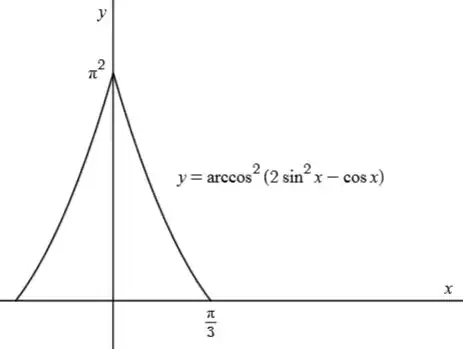

Show that $$\int_0^{\pi/3}\arccos^2(2\sin^2 x-\cos x)\mathrm dx=\frac{19\pi^3}{135}$$
Wolfram strongly suggests that it's true.
Here is the graph of $y=\arccos^2(2\sin^2 x-\cos x)$.
