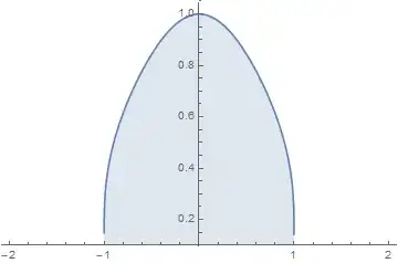

enter image description here $$\newcommand{\arctanh}{~\mathrm{arctanh}~}\newcommand{\sech}{~\mathrm{sech}~}$$
$$I=\int_{-1}^1\frac{\arctan x}{\arctanh x}\,\mathrm{d}x$$ Mathematica gives an approximate result of $I=1.581949621806183890451628...$, but no exact form. I predict it's a function of $e$ and $\pi$, and perhaps even the Golden Ratio $\phi$ (It certainly wouldn't be the first time)
The motivation behind this question is pure curiosity. I thought the shape looked nice :)
