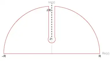

Now we integrate $f(z)=\frac{z^5+2z^3}{z^8+z^4+2z^2+1} \tan^{-1}(z)$ along a positively oriented, semicircular contour $C$ in the upper imaginary half-plane with radius $R>1$, and with an indentation surrounding the branch cut along $[i,i\infty)$ and encircling the branch point at $z=i$. On the principal branch, we have
$$\tan^{-1}(z) = -\frac i2 \log\left(\frac{i-z}{i+z}\right) = -\frac i2 \log\left|\frac{i-z}{i+z}\right| + \frac12 \arg\left(\frac{i-z}{i+z}\right)$$
It's easy to show the integrals along the circular arcs vanish as $R\to\infty$ and $\varepsilon\to0$ (the radius of the small circle). The integral along the real axis converges to $I$. This leaves us with the contribution of the integrals along the vertical line segments.
Parameterize the right and left paths, respectively, by
$$A : z = \varepsilon + it , t\in[R,1+\varepsilon] \\ B : z = -\varepsilon + it , t\in[1+\varepsilon,R]$$
As $\varepsilon\to0$, the integral along $A$ converges to
$$\begin{align*} \lim_{\varepsilon\to0} \int_A f(z) \, dz &= -\int_1^\infty f(it) \, i \, dt \\[1ex] &= -\int_1^\infty \frac{(it)^5+2(it)^3}{(it)^8+(it)^4+2(it)^2+1} \left(-\frac i2 \log\left|\frac{i-it}{i+it}\right| + \frac\pi2\right) \, i \, dt \\[1ex] &= -\frac i2 \int_1^\infty \frac{t^5-2t^3}{t^8+t^4-2t^2+1} \log\left|\frac{1-t}{1+t}\right| \, dt + \frac\pi2 \int_1^\infty \frac{t^5-2t^3}{t^8+t^4-2t^2+1} \, dt \end{align*}$$
while the integral along $B$ converges to
$$\begin{align*} \lim_{\varepsilon\to0} \int_B f(z) \, dz &= \int_1^\infty f(it) \, i \, dt \\[1ex] &= \int_1^\infty \frac{(it)^5+2(it)^3}{(it)^8+(it)^4+2(it)^2+1} \left(-\frac i2 \log\left|\frac{i-it}{i+it}\right| - \frac\pi2\right) \, i \, dt \\[1ex] &= \frac i2 \int_1^\infty \frac{t^5-2t^3}{t^8+t^4-2t^2+1} \log\left|\frac{1-t}{1+t}\right| \, dt + \frac\pi2 \int_1^\infty \frac{t^5-2t^3}{t^8+t^4-2t^2+1} \, dt \end{align*}$$
