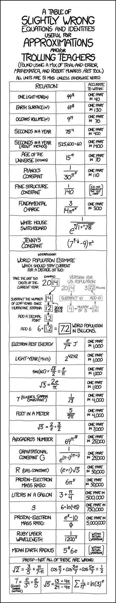

Obligatory xkcd
xkcd
Flavour text : Two tips: 1) $8675309$ is not just prime, it's a twin prime, and 2) if you ever find yourself raising $\log$(anything)^$e$ or taking the $\pi$-th root of anything, set down the marker and back away from the whiteboard; something has gone horribly wrong.
