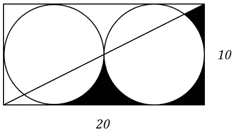

Don't let the simplicity of this diagram fool you. I have been wondering about this for quite some time, but I can't think of an easy/smart way of finding it.
Any ideas?
For reference, the Area is:
$$\bbox[10pt, border:2pt solid grey]{90−18.75\pi−25\cdot \arctan\left(\frac 12\right)}$$

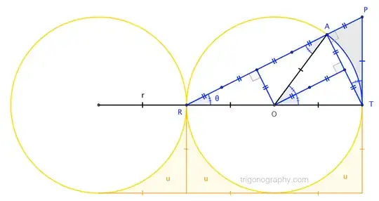

We observe that $\triangle PRT$ can be partitioned into five congruent sub-triangles. Therefore, the entire shaded region has area given by ... $$\begin{align} 3 u + |\text{region}\; PAT| &= 3u + |\square OAPT| - |\text{sector}\;OAT| \\[6pt] &= 3u + \frac{3}{5}\,|\triangle PRT| - |\text{sector}\;OAT| \\[6pt] &= 3\cdot\frac{1}{4} r^2 \left( 4 - \pi \right) \;+\; \frac{3}{5}\cdot r^2 \;-\; \frac{1}{2}r^2\cdot 2\theta \end{align}$$ Since $\theta = \operatorname{atan}\frac{1}{2}$, this becomes
$$r^2\left(\; \frac{18}{5} - \frac{3}{4}\pi - \operatorname{atan}\frac{1}{2} \;\right) \qquad\stackrel{r=5}{\to}\qquad 90 - \frac{75}{4}\pi - 25\;\operatorname{atan}\frac{1}{2}$$
Blue
  • 83,939
    Beautiful and instructive! (+1) – Markus Scheuer Jul 31 '16 at 07:25
    @MarkusScheuer: Thanks. I actually like this one enough that I posted it to my trigonography site. :) – Blue Jul 31 '16 at 08:53
    Nice examples and presentation on your site. One extra plus. :-) – Markus Scheuer Jul 31 '16 at 09:01
    "We observe..." (after thinking about it for a day or so) "...that $\triangle PRT$ can be partitioned..." - very pretty, well done. – Joffan Jul 31 '16 at 16:37
    @Joffan: It’s worth recalling the story of the very famous mathematician G.H. Hardy, who in a lecture said about some detail in a proof: “This is obvious.” After a pause, he went on: “Hmm, is it really obvious?” After another pause he left the room to consider the point, returning 20 minutes later with the verdict: “Yes, I was right, it is obvious.” —J.R. Partington (via DavidMarcus.com's Math Jokes page) Incidentally, the above was my third pass at this problem. (My second is in the edit history.) :) – Blue Jul 31 '16 at 16:50
    I know and love that story. I had a lecturer who had a go-to phrase of "this result is trivial", so we would write down results with the acronym "pbt", meaning "proof by triviality". – Joffan Jul 31 '16 at 17:00
    Awesome! How did you notice the 5 congruent triangles? Wow! Love this answer! – The Artist Jul 31 '16 at 19:01
    @TheArtist: Long story. My 2nd attempt (see edit history) noted that $|PA| = |PR|/5$, which seemed significant to me. Then Christian posted an answer that inspired me to look at the larger shaded area. Eventually, various fifths-of-$r^2$ triangle areas I was encountering suggested that I could/should be conveying their sizes visually, without so darned much algebraic manipulation. (After all, visualization is supposed to be my thing!) The full dissection revealed itself after a couple of "obvious" cuts. I was pleasantly surprised by how neatly it all worked-out. :) – Blue Jul 31 '16 at 20:05
  • @TheArtist: Thanks for the bounty! :) By the way ... Where did you get this puzzle? I want to give proper credit on my site. – Blue Aug 02 '16 at 14:13
  • How do you get that kind of pictures? Very nice. Visio? – user4951 Aug 09 '16 at 07:39
  • @JimThio: Thanks. I use GeoGebra. – Blue Aug 09 '16 at 07:43

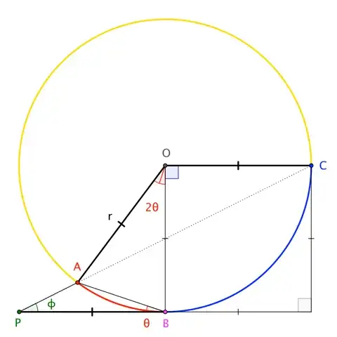

[Note: My second answer is much better.]
I'll focus on the unshaded region at the bottom-left.
By an aspect of the Inscribed Angle Theorem, we know that $\angle AOB = 2\;\angle ABP$ (justifying marking these $\theta$ and $2\theta$). By a related result, we have that $$\phi = \frac{1}{2}\left(\angle BOC - \angle AOB\right) = 45^\circ - \theta$$ Moreover, we know that $$\phi = \operatorname{atan}\frac{1}{2} \approx 26.56^\circ \qquad\to\qquad \theta = 45^\circ - \operatorname{atan}\frac{1}{2} \approx 18.43^\circ$$
From here, knowing the circle's radius, one may calculate the lower-left area as ... $$\begin{align} &|\triangle PAB| + |\triangle OAB| - |\text{sector } OAB| \\ \end{align}$$ ... from which we readily derive the area in the original question. For now, I'll leave these details to the reader.
Blue
  • 83,939
    What software do you use to draw figures? It's beautiful. – The Artist Jul 29 '16 at 10:36
    @theartist Geogebra is free and makes it easy to make things like this. – Mark S. Jul 29 '16 at 10:39
  • @MarkS. Thanks a lot mark :) – The Artist Jul 29 '16 at 10:41
    Does the theorem need to be invoked? You have an isosceles triangle so the angles OAB and OBA must be 90 - theta. PB is a tangent and OB is a radius so perpendicular. So ABP is theta. – Carlos Jul 29 '16 at 14:10
    @Carlos: You've basically explained why the "tangent" case of the IAT works, so it doesn't really matter whether one invokes the IAT or makes that argument explicitly. Be that as it may ... I use the related angle-subtraction result to calculate $\phi$, so invoking IAT first helps set the conceptual mood. (Note: the related result isn't entirely necessary here, either. We have $\angle ACB = \theta$ (it's an inscribed angle), and thus that $\angle OPC = \theta$ (alternate interior angles), which in turn gives $\theta + \phi = 45^\circ$. I wonder if that's a "better" way to think about this.) – Blue Jul 29 '16 at 15:37
    Another way to find φ, perhaps a little longer but using very elementary steps: OAC = OCA = φ (by internal angles of an isosceles tri, then by alternating angles); also CAB = φ + θ (by running a horizontal line through A); so OAC = 2φ + θ, and so summing the internal angles of the triangle OAC, we get 180° = (2θ) + (2φ + θ) + (2φ + θ) = 4φ + 4θ. – Peter LeFanu Lumsdaine Jul 29 '16 at 23:11

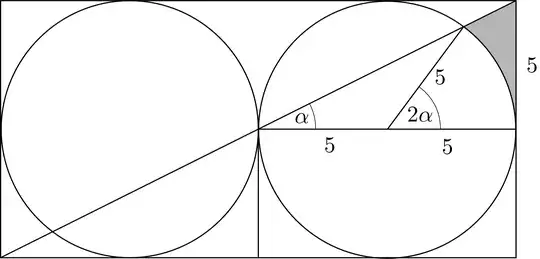

20
Put $\arctan{1\over2}=:\alpha$. Then $$\sin(2\alpha)={2\tan\alpha\over1+\tan^2\alpha}={4\over5}\ .$$ The area $A$ in question consists of three "arrow heads" plus the area shaded in the following figure. The latter is a right triangle minus a sector and a smaller triangle. We therefore obtain $$A={3\over4}(10^2- 25\pi)+{25\over2}\bigl(2-2\alpha-\sin(2\alpha)\bigr)=90-{75\over4}\pi-25\alpha\ .$$

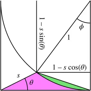

11
Considering the right triangle with legs $1-s\sin(\theta)$ and $1-s\cos(\theta)$, we have $$ 1=(1-s\cos(\theta))^2+(1-s\sin(\theta))^2\tag{1} $$ Solving for $s$, we get $$ s=\sin(\theta)+\cos(\theta)-\sqrt{2\sin(\theta)\cos(\theta)}\tag{2} $$ Setting $t=\tan(\theta)$ yields $$ \begin{align} s\sin(\theta)&=\frac{t}{1+t^2}\left(t-\sqrt{2t}+1\right)\\ s\cos(\theta)&=\frac{1}{1+t^2}\left(t-\sqrt{2t}+1\right)\\ \tan(\phi/2)&=\frac{1-s\cos(\theta)}{2-s\sin(\theta)} \end{align}\tag{3} $$ Setting $\tan(\theta)=\frac12$ gives $$ \begin{align} s\sin(\theta)&=\frac15\\ s\cos(\theta)&=\frac25\\ \tan(\phi/2)&=\frac13 \end{align}\tag{4} $$ The area of the green piece is $$ \frac\phi2-\frac12(1-s\cos(\theta))=\tan^{-1}\left(\frac13\right)-\frac3{10}\tag{5} $$ The sum of the areas of the purple and green pieces is $$ \frac12s\sin(\theta)=\frac1{10}\tag{6} $$ Therefore, the area of the purple piece is $$ \frac25-\tan^{-1}\left(\frac13\right)\tag{7} $$
$(7)$ used a circle with radius $1$. For a circle with radius $5$, we get an area of $$ 10-25\tan^{-1}\left(\frac13\right)\tag{8} $$ The area of half the $10\times20$ rectangle minus the two circles of radius $5$ is $$ 100-25\pi\tag{9} $$ Therefore, the area in the given image is the difference of $(9)$ and $(8)$: $$ \bbox[5px,border:2px solid #C0A000]{90+25\tan^{-1}\left(\frac13\right)-25\pi}\tag{10} $$
$(10)$ is a different form of the same area: $$ \begin{align} 90+25\tan^{-1}\left(\frac13\right)-25\pi &=90+25\tan^{-1}\left(\frac13\right)-25\tan^{-1}\left(1\right)-\frac{75}4\pi\\ &=90+25\tan^{-1}\left(\frac{\frac13-1}{1+\frac13\cdot1}\right)-\frac{75}4\pi\\ &=\bbox[5px,border:2px solid #C0A000]{90-25\tan^{-1}\left(\frac12\right)-\frac{75}4\pi}\tag{11} \end{align} $$

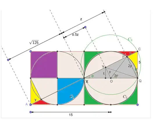

My method is just an ordinary one but it shows how the suggest answer is obtained.
It should be clear that how the lengths and angles are defined as shown.
$\theta = \tan^{-1}(\dfrac {1}{2})$ in radians.
By power$(A, C_2)$, $z = \dfrac {100}{\sqrt {125}}$. Then, by power $(P, C_3)$, $y = \dfrac {25}{\sqrt {125}}$.
By similar triangles, $t = … = 2$.
After transferring the leftmost black shaded part to its more suitable position (above X), the required area
$= [(10 \times 10) square] - [C_2] - [red]$
$= 100 - 25 \pi - ([purple] - [\dfrac {C_1}{4}] - [yellow])$
$= 100 - 25\pi – 25 + \dfrac {25\pi}{4} + [yellow]$
$= 75 - 18.75\pi + [yellow]$
$= 75 - 18.75\pi + ([⊿XCQ] - [grey])$
$=75 - 18.75\pi + 25 - [grey]$
$= 100 - 18.75\pi - ([⊿XYQ] + [section YPQ] $
$= 100 - 18.75\pi - ([⊿XYQ] + [sector OPQ] $
$= 100 - 18.75\pi - (10 + \dfrac {(25)2\theta}{2})$
$= 90 - 18.75\pi - 25\tan^{-1}(\dfrac {1}{2})$
Mick

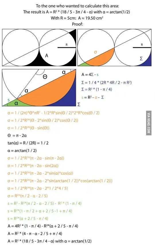

I posted a solution directly on 9gag:
Zev Chonoles
