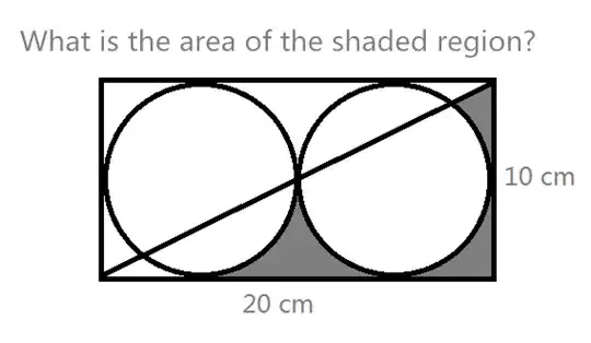

I have solved so far this
Image is in the form of link
Rectangle area$= 10*20=200cm^2$
Circle diameter=$10cm$
Radius=$5cm$
1 circle area=$3.1456*5^=78.64cm^2$
2 circle area=$2*78.64=157.28$
Area outside circle boundry=$200-157.2=42.72cm^2$
Area in the lower triangle=$42.72/2=21.36cm^2$
Area of Square if we draw line in between=$100cm^2$
Area outside of circle in square=$100-78.64=21.36cm^2$
Area of each of size outside of circle halved=$21.36/8=2.67cm^2$
But the triangle line deosn't properly half the area on circle sides in squares what to do?
Estimated could be this=$18.69cm^2$
But this is not true because the line cutting doesn't properly half it.
Answer Plz!
