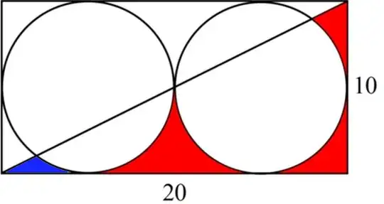

How do I find the area shaded in red? The difficulty is actually in finding the area in blue.

1With a little integral calculus the blue part is not that problematic to calculate, imo.: $$\int_0^2\frac x2,dx+\int_2^5\left(\sqrt{10x-x^2}+5\right)dx\ldots$$ – DonAntonio Apr 28 '17 at 12:45

Here is a video on youtube where a guy solves exctly this problem: https://www.youtube.com/watch?v=xnE_sO7PbBs&t=2s
