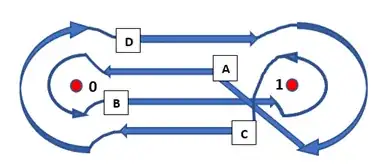

    As promised, placed the info regarding the Pochhammer contour and analytically continued Beta-function. In fact, this is a powerful tool to to evaluate specific type of integral (yours is an example, and not the most complicated one ;) – Svyatoslav Apr 30 '21 at 07:40
This is related to Pochhammer contour and a bit long for adding to the previous post.
The contour P looks like enter image description here
The path consists of the line from $r$ to $1-r\,$ ($r\to0$) on the axis $X$ and small circles of radius $r\to0$ around points $x=0$ and $x=1$.
We start with the integrand $t^{x-1}(1-t)^{y-1}$; and let $I_r=\int_r^{1-r}t^{x-1}(1-t)^{y-1}dt$
  1. Integral along the path A: $I_A=-I_r$ (we go in the negative direction).
Integral around $0$ (counter clockwise): $\int_0^{2\pi}r^{x-1}e^{i\phi(x-1)}(1-re^{i\phi})^{y-1}ire^{i\phi}d\phi$. After the full turn the integrand gets the multiplier $e^{2\pi ix}$
  1. Integral along the path B: $I_B=+I_re^{2\pi ix}$
Integral around $1$ (counter clockwise): $-e^{2\pi ix}\int_0^{2\pi}(1-re^{i\phi})^{x-1}r^{y-1}e^{i\phi(y-1)}ire^{i\phi}d\phi$ (minus - due to $dt=d(1-re^{i\phi})=-ire^{i\phi}$. After the full turn - an additional multiplier ($e^{2\pi iy}$)
  1. Integral along the path C: $I_C=-I_re^{2\pi ix}e^{2\pi iy}$
Integral around $0$ (clockwise): $e^{2\pi ix}e^{2\pi iy}\int_0^{-2\pi}r^{x-1}e^{i\phi(x-1)}(1-re^{i\phi})^{y-1}ire^{i\phi}d\phi$. After the full turn - an additional multiplier ($e^{-2\pi ix}$) which cancels $e^{2\pi ix}$.
  1. Integral along the path D: $I_D=+I_re^{2\pi iy}$
Integral around $1$ (clockwise): $-e^{2\pi iy}\int_0^{-2\pi}(1-re^{i\phi})^{x-1}r^{y-1}e^{i\phi(y-1)}ire^{i\phi}d\phi$. After the full turn - an additional multiplier ($e^{-2\pi iy}$) which cancels remaining $e^{2\pi iy}$.
We are coming back to the starting point and getting the initial integrand $t^{x-1}(1-t)^{y-1}$.
Considering integration along the full closed contour (taking all together) we get $$\oint_Pt^{x-1}(1-t)^{y-1}dt=-\Bigl(e^{2\pi ix}-1\Bigr)\Bigl(e^{2\pi iy}-1\Bigr)I_r$$ $$-\Bigl(e^{2\pi iy}-1\Bigr)\int_0^{2\pi i}r^xe^{i\phi x}(1-re^{i\phi})^{y-1}id\phi-\Bigl(e^{2\pi ix}-1\Bigr)\int_0^{2\pi i}(1-re^{i\phi})^{x-1}r^ye^{i\phi y}id\phi$$ $$B(x,y)=-\frac{1}{(\exp(2\pi{i}x)-1)(\exp(2\pi{i}y)-1)}\oint_Pt^{x-1}(1-t)^{y-1}dt$$ $$=I_r+\frac{1}{e^{2\pi ix}-1}\int_0^{2\pi i}r^xe^{i\phi x}(1-re^{i\phi})^{y-1}id\phi+\frac{1}{e^{2\pi iy}-1}\int_0^{2\pi i}(1-re^{i\phi})^{x-1}r^ye^{i\phi y}id\phi$$ $$=I_r+\frac{1}{e^{2\pi ix}-1}\int_1^{e^{2\pi i}}r^xt^{x-1}(1-rt)^{y-1}dt+\frac{1}{e^{2\pi iy}-1}\int_1^{e^{2\pi i}}(1-rt)^{x-1}r^xt^{y-1}dt$$ $$=I_r+I(x,y)+I(y,x)$$ where $$I(x,y)=\frac{1}{e^{2\pi ix}-1}\int_1^{e^{2\pi i}}r^xt^{x-1}(1-rt)^{y-1}dt$$ $$=\frac{1}{e^{2\pi ix}-1}\int_1^{e^{2\pi i}}r^xt^{x-1}\bigl(1-rt(y-1)+(y-1)(y-2)\frac{r^2t^2}{2!}+...\bigr)dt$$ $$=\frac{r^x}{x}-\frac{r^{x+1}}{x+1}(y-1)+\frac{r^{x+2}}{x+2}\frac{(y-1)(y-2)}{2!}+...$$
