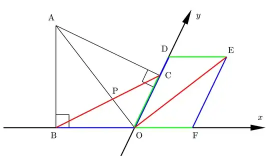

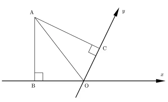

Well, we can prove the BAC-CAB identity using only geometric arguments as follows.
First consider a coordinate system where the $x$- and $y$-axes are skewed (non-orthogonal). We project the line $\mathrm{OA}$ orthogonally onto the axes, forming the quadrilateral $\square\mathrm{ABOC}$. enter image description here We then construct the parallelogram $\square\mathrm{OFED}$ with sides $\mathrm{OF} = \mathrm{DE} = \mathrm{OC}$ and $\mathrm{OD} = \mathrm{FE} = \mathrm{BO}$ and the diagonal $\mathrm{OE} = \mathrm{BC}$. Then, by construction,
$$\begin{aligned} \overrightarrow{\mathrm{OE}} &= \mathrm{OF}\,\hat{x} + \mathrm{FE}\,\hat{y} \\ & = \mathrm{OC}\,\hat{x} + \mathrm{OB}\,\hat{y} \\ & = (\mathrm{OA} \cdot \cos{\angle \mathrm{AOC}})\,\hat{x} + (\mathrm{OA} \cdot \cos{\angle \mathrm{BOA}})\,\hat{y} \\ & = (\overrightarrow{\mathrm{OA}} \boldsymbol{\cdot} \hat{y})\,\hat{x} - (\overrightarrow{\mathrm{OA}} \boldsymbol{\cdot} \hat{x})\,\hat{y}, \end{aligned} \label{eq1} \tag{1}$$

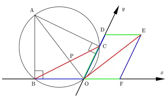

where $\hat{x}$ and $\hat{y}$ are unit basis vectors. enter image description here We note that $\square\mathrm{ABOC}$ is a cyclic quadrilateral since $\angle\mathrm{BAC} + \angle\mathrm{BOC} = \angle\mathrm{ABO} + \angle\mathrm{ACO} = 180^\circ$. It can therefore be inscribed in a circle and the intersecting chords theorem gives us $$\mathrm{AP} \cdot \mathrm{PO} = \mathrm{BP} \cdot \mathrm{PC}$$ such that $\Delta\mathrm{ABP} \sim \Delta\mathrm{COP}$ and $\Delta\mathrm{BOP} \sim \Delta\mathrm{ACP}$ (triangles are similar). enter image description here From the law of sines we get that $$ \frac{\mathrm{OE}}{\sin \angle\mathrm{OFE}} = \frac{\mathrm{FE}}{\sin \angle\mathrm{EOF}} = \frac{\mathrm{BO}}{\sin \angle\mathrm{BCO}} = \frac{\mathrm{OA} \cdot \cos \angle\mathrm{BOA}}{\sin \angle\mathrm{BCO}} = \mathrm{OA}$$ as $\angle\mathrm{BOA} = \angle\mathrm{BCA} = 90^\circ - \angle\mathrm{BCO}$. Thus $$ \mathrm{OE} = \mathrm{OA} \cdot \sin \angle\mathrm{OFE} = \mathrm{OA} \cdot \sin \angle\mathrm{DOF}$$ which is equivalent to $$|\overrightarrow{\mathrm{OE}}| = |\overrightarrow{\mathrm{OA}}| \cdot \sin \angle\mathrm{DOF} = |\overrightarrow{\mathrm{OA}} \times (\hat{x} \times \hat{y})|. \label{eq2} \tag{2}$$ We can also see that $$ \angle\mathrm{AOE} = \angle\mathrm{AOC} + \angle\mathrm{COE} = \angle\mathrm{ABP} + \angle\mathrm{PBO} = 90^\circ. \label{eq3} \tag{3}$$
$(\ref{eq2})$ and $(\ref{eq3})$ combined thus proves that $$ \overrightarrow{\mathrm{OE}} = \overrightarrow{\mathrm{OA}} \times (\hat{x} \times \hat{y}) \label{eq4} \tag{4}$$ (correct magnitude and direction as given by the right-hand rule). We can now set $\vec{a} \equiv \overrightarrow{\mathrm{OA}}$ and combine eqs. $(\ref{eq1})$ and $(\ref{eq4})$;
$$ \vec{a} \times (\hat{x} \times \hat{y}) = (\vec{a} \boldsymbol{\cdot} \hat{y})\,\hat{x} - (\vec{a} \boldsymbol{\cdot} \hat{x})\,\hat{y}. $$
Finally, multiplying both sides with some scalars $b$ and $c$ gives us
$$ \vec{a} \times (\vec{b} \times \vec{c}) = (\vec{a} \boldsymbol{\cdot} \vec{c})\,\vec{b} - (\vec{a} \boldsymbol{\cdot} \vec{b})\,\vec{c}. $$
Note that this also holds for any vector $\vec{a}$, even one which is not parallel to the $xy$-plane, as any component perpendicular to this plane is mapped to zero when taking the cross and dot products.
So to answer the question, I guess the rule can be said to hold due to a (rather complex) geometrical relation between the two quadrilaterals $\square\mathrm{ABOC}$ and $\square\mathrm{OFED}$ formed as above. The last multiplication step can be thought of as scaling the relevant sides of these equally.
