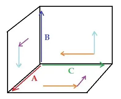

This attempt at an answer is geometric in the sense that it is stated in terms of vectors and not components.
Geometrically the double-cross product is given by $$\vec{a} \times (\vec{b} \times \vec{c}) = (\vec{a} \cdot \vec{c}) \vec{b}- (\vec{a} \cdot \vec{b}) \vec{c}.$$ This shows three things:
  1. $\vec{a} \times (\vec{b} \times \vec{c}) = (\vec{a} \cdot \vec{c}) \vec{b}- (\vec{a} \cdot \vec{b}) \vec{c}$ falls in the plane spanned by $\vec{b}$ and $\vec{c}$
  2. $\vec{b} \times (\vec{c} \times \vec{a}) = (\vec{b} \cdot \vec{a}) \vec{c}- (\vec{b} \cdot \vec{c}) \vec{a}$ falls in the plane spanned by $\vec{c}$ and $\vec{a}$
  3. $\vec{c} \times (\vec{a} \times \vec{b}) = (\vec{c} \cdot \vec{b}) \vec{a} - (\vec{c} \cdot \vec{a}) \vec{b}$ falls in the plane spanned by $\vec{a}$ and $\vec{b}$
Add these relations the terms in the $\vec{a},\vec{b}$ and $\vec{c}$ directions cancel thus revealing the Jacobi Identity.
We could visualize these in terms of three planes which intersect along the directions $\vec{a},\vec{b}, \vec{c}$. I illustrate as if they are orthogonal as to keep the picture manageable. The idea here is the lengths of the orange, purple and cyan arrows are indicative of the dot-products which appear in the spans.
James S. Cook
