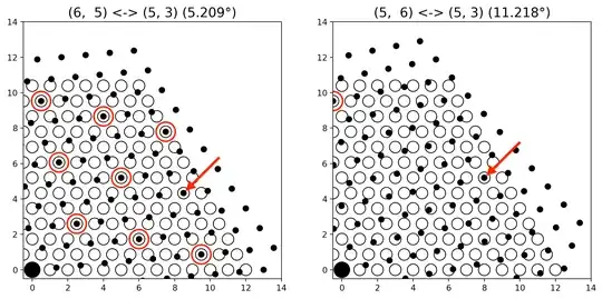

A pair of hexagonal lattices with one scaled by the square root of a rational number $r = \sqrt{\frac{m}{n}}$ and then rotated will produce a variety of different hexagonal lattices of coincident points.
For the first lattice let
$$x, y = i+\frac{1}{2}j, \ \frac{\sqrt{3}}{2}j$$
and for the second
$$x, y = r\left(k+\frac{1}{2}l\right), \ r\left(\frac{\sqrt{3}}{2}l\right).$$
Per this and this helpful answer the squares of the distances to unit lattice points are given by Loeschian numbers (A003136) equal to $i^2+ij+j^2$ so in this case a point $i, j$ on the first lattice will coincide with a point $k, l$ on the second lattice once rotated by some amount if
$$n(i^2+ij+j^2) = m(k^2+kl+l^2).$$
For example if $m, n = 13, 7$ then both $(i, j) = (5, 6)$ and $(6, 5)$ will coincide with $(k, l) = (5, 3)$ at rotation angles of about 5.2 and 11.2 degrees as given by.
$$\theta = \arctan\left( \frac{\frac{\sqrt{3}}{2}l}{k+\frac{1}{2}l} \right) - \arctan\left( \frac{\frac{\sqrt{3}}{2}j}{i+\frac{1}{2}j} \right)$$
However, while the first solution is part of the hexagonal superlattice built on the much closer point $(i, j), (k, l) = (1, 3), (1, 2)$ the second point represents the shortest possible coincident distance and therefore a far lower density coincident lattice.
Question: Is there a simple test that can be applied to the pairs (5, 6), (3, 5) and (6, 5), (3, 5) (and knowing m, n) that will indicate immediately that one is based on a superlattice of much smaller period but the other represents the shortest distance in a much more sparse coincident lattice?
This answer and this comment below it provide some related tests and might adapted here, but ideally I'm looking for a yes/no test that does not involving testing all points closer.

(I will use $p,q$ insteaf of your $i,j$, because I will use $i$ for the imaginary unit.)
Set $u := \frac{1+\sqrt{3} i}{2}$. Consider the set $\{a+bu\mid a,b\in\mathbb{Z}\}$. Since $u^2=u-1$, a product of two such numbers belongs to this set as well. I will denote this set $\mathbb{Z}[u]$.[1]
If your first lattice is put on the complex plane, its points will correspond exactly to elements of $\mathbb{Z}[u]$. And since scaling and rotating around the origin correspond to multiplication by a complex number, the points of your second lattice will correspond to numbers of the form $Az_1$, where $A\in \mathbb{Z}[u]$ and $z_1\in\mathbb{C}$ is the number where the point 1 ended up after the rotation and scaling.
In your case, $z_1$ is given by $P=Kz_1$, where $P=p+qu$ and $K=k+lu$ are elements of $\mathbb{Z}[u]$. The coincident points correspond to numbers $P'\in \mathbb{Z}[u]$ which can be represented as $P' = K'z_1$, where $K'\in \mathbb{Z}[u]$. You want to know whether there are such $P'$ with $0<|P'|<|P|$.
Assume that there are and that $P_1 = K_1z_1$ a coincident point with the minimal non-zero absolute value (i.e., closest to the origin). Since the coincident points form a hexagonal lattice, $P$ can be represented as $P=AP_1$, where $A\in\mathbb{Z}[u]$. Then $Kz_1 = AK_1z_1$, i.e., $K = AK_1$.
So if there is a coincident point closer to the origin than $P$, then there are elements $A, P_1, K_1\in \mathbb{Z}[u]$ such that $AP_1 = P$, $AK_1 = K$, and $|A|>1$. The converse is also true: if such $A, P_1, K_1\in \mathbb{Z}[u]$ exist, then $P_1 = K_1z_1$ is a coincident point, and since $|P_1| = \frac{|P|}{|A|}<|P|$, it is closer to the origin than $P$.
Therefore, the thing you want to know is equivalent to the following: given the elements $P=p+qu$ and $K=k+lu$ of $\mathbb{Z}[u]$, do they have a common divisor in $\mathbb{Z}[u]$ whose absolute value is greater than 1? This can be decided using Euclid's algorithm:
  • Set variables $A:= p+qu$ and $B:=k+lu$; if $|A|<|B|$, switch $A$ and $B$ in places.
  • While $B\neq 0$, repeat: Calculate $\frac AB$ [2] and "round" it to the nearest element of $\mathbb{Z}[u]$,[3] let's denote it $D$. Set $B$ to $A-DB$ and $A$ to the old value of $B$.(end of loop)
  • If $|A|=1$ (i.e., if $A$ is one of the numbers $\pm 1, \pm u, \pm(u-1)$), then the numbers $p+qu$ and $k+lu$ have no common divisors in $\mathbb{Z}[u]$ other than $\pm 1, \pm u, \pm(u-1)$; in the terms of your problem, it means that the corresponding coincident point is closest to the origin. Otherwise, there are closer points.
For example, if we start with values $A = 6+5u$ and $B = 5+3u$, then $\frac{A}{B} = \frac{9+u}{7}$; the closest element of $\mathbb{Z}[u]$ is $1$, so the values of $A$ and $B$ change to $5+3u$ and $6+5u - 1(5+3u) = 1+2u$. Now, $\frac{5+3u}{1+2u} = 3-u$, which lies in $\mathbb{Z}[u]$, so the values of $A$ and $B$ change to $1+2u$ and $0$. Since $|1+2u|>1$, we see that there must be a coincident point closer to the origin. And if you apply the algorithm to the starting values $5+6u$ and $5+3u$, you will find that there are no closer coincident points in that case. (I think that the inscriptions on your pictures are wrong: the first one corresponds to $(6,5)\leftrightarrow (5,3)$, and the second one to $(5,6)\leftrightarrow (5,3)$.)
