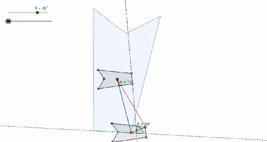

When the there is no rotation of the revealing layer, the pinholes lie directly over the corresponding figure 2's in the base layer. Assuming that the pinholes are actually "inside" their corresponding figures, the resulting composite image will be black. As we start to rotate the revealing layer, the pinholes will start to move to the "outside" of their corresponding layers. If we follow a given pinhole, it will turn white as it moves outside of its underlying figure, and then will begin "twinkling" black and white as it moves over non-corresponding figures. So we want to see how/when that transition from "inside" to "outside" occurs.
In the diagram below the figures on the base layer are concave pentagons, in the shape of the static gray pentagon. The large green dot inside that pentagon represents the unrotated corresponding pinhole. For our purposes we'll assume that it's at the center of the revealing layer - call it the "origin". The rightmost segment of that pentagon lies on a dashed black line. We'd like to know, for a given rotation, when it is that other pinholes transition from "inside" to "outside" their corresponding figures. It turns out, that for a rotation of angle $\theta$, any pinhole who's unrotated position is on the dashed green line will be on the border of its corresponding figure. The dashed green line can be calculated by applying a transform $T_{\theta}$ to the black dashed line. $T_{\theta}$ consists of a rotation of $-\pi/2-\theta/2$ and a scaling factor of $\dfrac{1}{2\sin(\theta/2)}$
In the diagram, $\theta=16°$, so the angle between the black and green dashed lines is $98°$. The light blue pentagon is the result of applying $T_{\theta}$ to the static pentagon.
The animation shows a variable pinhole (the hollow red point) moving along the boundary of the light blue pentagon. The solid red point shows the pinhole rotated by $\theta$. Note the red point moves along the border of its corresponding base layer figure. Pinholes whose unrotated position is inside the light blue pentagon will still be inside their corresponding base layer figures after a rotation of $\theta$, while pinholes starting outside of the light blue pentagon will be outside of their corresponding figures.
The upshot of this is that the light blue pentagon is the dark moiré region observed in the OP. It will scale and rotate according to $T_{\theta}$ as the revealing layer rotates. For negative $\theta$ it will invert. Finally, for small $\theta$ the moiré region will appear to be perpendicular to the base layer figures, but this is only approximately true.
