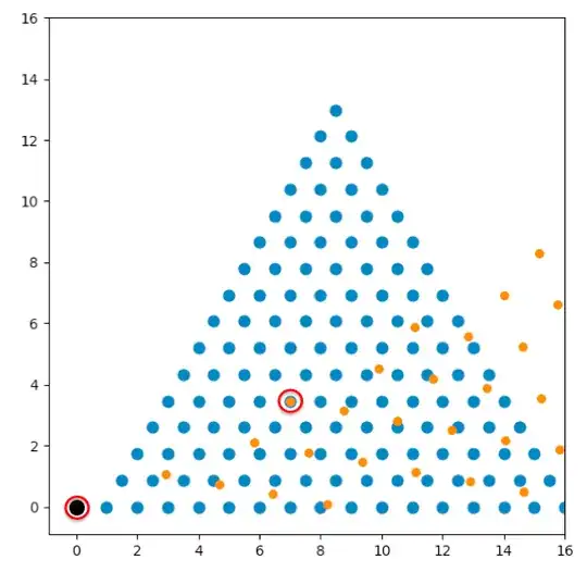

Example of a proper coincident lattice: $(i, j), (k, l) = (5, 4), (2, 3)$ with $\frac{a_2}{a_1} = \sqrt{\frac{61}{19}}$ and $n_{max} = 16$ with cuts at $0 \le \theta_{ij} < 60°$ and $0 \le \theta_{kl} < 30°$. This finds exactly one coincidence point. Are these angle restrictions correct to find all near-coincident solutions? Ignoring solutions with lowest common denominators $LCD(i, j, k, l) > 1$ will help avoid some redundancies.
example of coincident lattice with angle restrictions

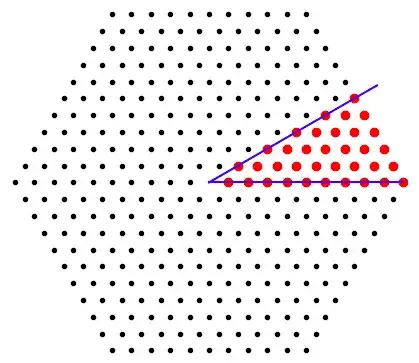

I believe I've solved my problem but I don't know how to offer a formal proof for this.
It's clear that it is sufficient to include only the points in $0 \le \theta \le 30°$ from each lattice in order to find all possible lengths in each.
Each lattice is 6-fold symmetric so rotations from one lattice to the other are only unique within for example $-30° \le R \le 30°$ range, and every rotation at $+R$ will have a mirror point at $-R$
So use points in each lattice within $0 \le \theta \le 30°$ and for every rotation $\mod(R, 30°) \ne 0$ include a second rotation at $-R$.
hexagonal lattice
plot: https://pastebin.com/fnxGV3Yc

    You will note that every point in the $30°$ wedge has $0 \le j \le i$; searching this segment is equivalent to trying Loeschian numbers, generating them using for (i = 0; i <= n; i++) { for (j = 0; j <= n; j++). The conceit of considering angles and all that is actually way overkill for this problem once you've reduced it to number crunching like this. – Dan Uznanski May 14 '20 at 23:15
