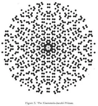

Eisenstein-Jacobi Primes from Unsolved Problems in Number Theory Third Edition, Richard K. Guy, Springer, 2004, (A16 Gaussian and Eisenstein-Jacobi primes, pp 55-57) click for larger

  • That's a weird graphic! When I read the text above and below it, I get the distinct impression that the central cluster is moving. – TonyK Apr 29 '23 at 02:29
