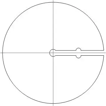

This integral may be evaluated using the residue theorem. That said, the evaluation is very subtle and requires a bit of carrying around diverging quantities that cancel. Also, the contour of integration in this case should have a detour around the removable singularity. We proceed as follows.
Consider the contour integral
$$\oint_C dz \frac{\log^3{z}}{(z^2-1)^2} $$
where $C$ is the following contour:
where the bumps about the removable singularity at $z=1$ are semicircles of radius $\epsilon$ and the outer circle has a radius $R$. We parametrize the contour to evaluate the contour integral; accordingly, the contour integral is equal to
$$\int_{\epsilon}^{1-\epsilon} dx \frac{\log^3{x}}{(1-x^2)^2} + i \epsilon \int_{\pi}^0 d\phi \, e^{i \phi} \frac{\log^3{\left (1+\epsilon e^{i \phi} \right )}}{\left ( \left (1+\epsilon e^{i \phi} \right )^2-1 \right )^2} \\ + \int_{1+\epsilon}^{R} dx \frac{\log^3{x}}{(x^2-1)^2} + i R \int_0^{2 \pi} d\theta \, e^{i \theta} \frac{\log^3{\left ( R e^{i \theta} \right )}}{\left ( R^2 e^{i 2 \theta} \right )}\\ + \int_R^{1+\epsilon} dx \frac{\left (\log{x}+i 2 \pi \right)^3}{(x^2-1)^2}+ i \epsilon \int_{2 \pi}^{\pi} d\phi \, e^{i \phi} \frac{\left (\log{\left (1+\epsilon e^{i \phi} \right )}+i 2 \pi \right )^3}{\left ( \left (1+\epsilon e^{i \phi} \right )^2-1 \right )^2} \\+ \int_{1-\epsilon}^{\epsilon} dx \frac{(\log{x}+i 2 \pi)^3}{(1-x^2)^2} + i \epsilon \int_{2 \pi}^0 d\phi\, e^{i \phi} \frac{\log^3{\left ( \epsilon e^{i \phi} \right )}}{\left ( \epsilon^2 e^{i 2 \phi} \right )}$$
As $R \to \infty$, the fourth integral vanishes. As $\epsilon \to 0$, the second and eighth integrals vanish. In this limit, however, note that the second integrals opposite number, the sixth integral, does not vanish in this limit. Rather, the logs on the branch below the positive real axis have an $i 2 \pi$ added to them. This includes the log attached to the bump below the positive real axis, i.e., the sixth integral. This integral evaluates as follows for small $\epsilon$:

Ron Gordon
  • 141,538
