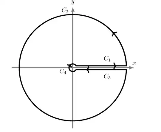

Now consider $f(z)=\frac{[\ln(z)]^2}{1+z^8}$ and the keyhole contour with $C=C_1\cup C_2\cup C_3\cup C_4$ and $r,R$ being the inner radius and outer radius respectively.
We then have:
$$\lim_{(r,R)\to(0^+,\infty)}\int_{C_2}f(z)~\mathrm dz=\lim_{(r,R)\to(0^+,\infty)}\int_{C_4}f(z)~\mathrm dz=0$$
$$\lim_{(r,R)\to(0^+,\infty)}\int_{C_1}f(z)~\mathrm dz=\int_0^\infty\frac{[\ln(z)]^2}{1+z^8}~\mathrm dz$$
$$\lim_{(r,R)\to(0^+,\infty)}\int_{C_3}f(z)~\mathrm dz=-\int_0^\infty\frac{[\ln(z)+2\pi i]^2}{1+z^8}~\mathrm dz$$
Adding these together, we find that
$$\begin{align}\lim_{(r,R)\to(0^+,\infty)}\oint_Cf(z)~\mathrm dz&=\int_0^\infty\frac{[\ln(z)]^2-[\ln(z)+2\pi i]^2}{1+z^8}~\mathrm dz\\&=\int_0^\infty\frac{-4\pi i\ln(z)+4\pi^2}{1+z^8}~\mathrm dz\end{align}$$
Thus,
$$\int_0^\infty\frac{\ln(z)}{1+z^8}~\mathrm dz=-\frac1{4\pi}\Im\left[\lim_{(r,R)\to(0^+,\infty)}\oint_Cf(z)~\mathrm dz\right]$$
$$\int_0^\infty\frac1{1+z^8}~\mathrm dz=\frac1{4\pi^2}\Re\left[\lim_{(r,R)\to(0^+,\infty)}\oint_Cf(z)~\mathrm dz\right]$$
Now apply residue theorem and you are done!

This is easy to prove using contour integration of $\dfrac{z^{-p}}{1+z}$ along the keyhole contour given in Simply Beautiful Art's answer. It follows from Eq. (1) that:
