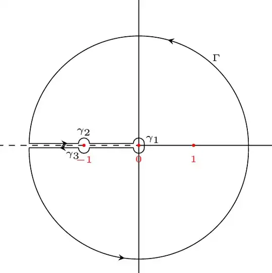

From your line (3), we have \begin{align} \int_{-\infty}^{\infty}\frac{\ln(t^2)}{t^2 - 1}dt &= \int_{\Gamma}f(t) + \int_{\gamma_1}f(t) + \int_{\gamma_2}f(t) + \int_{\gamma_3}f(t) \end{align} if we consider a key hole contour as picture below. enter image description here
Let radius of $\Gamma$ be $R$, $\gamma_1$ be $\epsilon$, $\gamma_2$ be $\delta_2$, and $\gamma_3$ be $\delta_3$ be $$ f(z) = \frac{\ln(z^2)}{z^2 - 1} = \frac{2(\ln|z| + i\arg(z))}{z^2-1} $$ As $R\to\infty$, $\int_{\Gamma}\to 0$, and as $\epsilon\to 0$, $\int_{\gamma_1}\to 0$ by the estimation lemma. \begin{align} \int_0^{\infty}\frac{\ln(x)}{(x-1)\sqrt{x}}dx &= 2\int_{-\infty}^{\infty}\frac{\ln(z)}{z^2-1}dz\\ &=\int_{\gamma_2}f + \int_{\gamma_3}f\\ &= \pi i\text{Res}(f; -1) - \pi i\text{Res}(f; -1)\\ \end{align} the second residue at $-1$ is negative for being in the lower half.

  • Why is $\int_{\gamma_2}f=\pi i \text{Res} (f;-1)$? Can't you unite $\gamma_2$ and $\gamma_3$ to get a full circle and then use Cauchy's theorem? – Minethlos Nov 20 '14 at 23:43
    @Minethlos can't make a full circle across a branch cut. If we do, we will have a multivalued integral. – dustin Nov 20 '14 at 23:55
  • I do not believe this is correct, since the branch cut of $\ln(z^2)$ will be along the imaginary axis, not along the negative real axis. – user2520938 Jun 17 '15 at 21:30

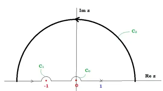

I claim that with these corrections my approach is correct.
  1. Instead of (4), I am integrating over the contour
$$\oint_\gamma = \int_{-R}^{-1-r}+ \int_{C_1}+\int_{-1+r}^{0}+\int_{C_0}+\int_0^R+\int_{C_2}=0 \tag6$$
where $C_1$ is semi-circle around $-1$, $C_0$ is semi-circle around $0$ and $C_2$ is the large semi-circle. There are no poles inside the contour.
  1. I choose the branch cut for logarithm $−iy,0≤y≤∞$.
  2. $\int_{C_0}=\int_{C_2}=0$ due to estimation lemma. Alternatively,
$$ \lim_{r\to0} \int_{C_0} \frac{\log z}{(z^2-1)}dz =\lim_{r\to0} \int_{C_1} \frac{\log (re^{i\phi}) \cdot ire^{i\phi} d\phi}{r^2e^{2i\phi}-1} \sim r\log r \sim 0 $$
which can be shown by using L'Hôpital.
  1. For $C_1: z=-1+r e^{i\phi}, \pi \ge \phi \ge 0$,
$$\lim_{r\to0} \int_{C_1} \frac{\log z}{(z^2-1)}dz =\lim_{r\to0} \int_{C_1} \frac{\log (-1+re^{i\phi} \cdot ire^{i\phi} d\phi}{(-1+re^{i\phi})^2-1} =\\ \lim_{r\to0} \int_{C_1} \frac{\log (-1+re^{i\phi}) i d\phi}{-2+re^{i\phi}} = \int_{C_1} \frac{\pi}{2} = \frac{\phi\pi}{2} \biggr|_\pi^0 = -\frac{\pi^2}{2} $$
  1. So, from (6) in the limit $r\to0, R\to\infty$ we have
$$ \int_{-\infty}^{\infty} \frac{\log t}{(t^2-1)}dt = \frac{\pi^2}{2} $$
and from (1)-(3)
$$ I=\pi^2 $$
Minethlos
  • 1,964
  • Isn't your contour along the x axis running right through the pole at $z = 1$? Also, if you enclose pole which is what I think you want to do, you will have $$\sum_i\int_{C_i} = \text{Res}(f;1)$$ where the $$2\pi i\lim_{t\to 1}(t-1)\frac{\ln|t| + i\cdot 0}{t^2 -1} =0$$. Then you will have $$\int f(x) =\sum_i\int_{C_i} = -\pi^2 = 0$$ add $\pi^2$ over and you have original integral is desired result. – dustin Nov 21 '14 at 02:21
  • @dustin I thought since 1 is a removable singularity, you can just define the function there as the limit $z\to 1$(which exists) and the singularity is removed. But, yes, the residue there is 0 anyway. – Minethlos Nov 21 '14 at 10:51
  • Well done, congratulations! :) – tired Nov 21 '14 at 14:29
