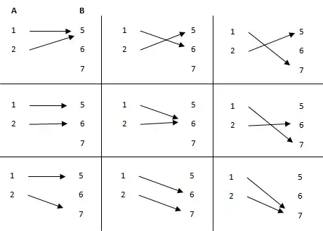

A function on a set involves running the function on every element of the set A, each one producing some result in the set B. So, for the first run, every element of A gets mapped to an element in B. The question becomes, how many different mappings, all using every element of the set A, can we come up with? Take this example, mapping a 2 element set A, to a 3 element set B. There are 9 different ways, all beginning with both 1 and 2, that result in some different combination of mappings over to B.
The number of functions from A to B is |B|^|A|, or $3^2$ = 9.

4Very thorough. Sadly I doubt the original poster will see it though. – Simon S Nov 08 '14 at 23:54
1Very good graphical approach. Helped me understand that the number of functions from set A is the number of functions counted silmutanuously – DoubleOseven Mar 07 '16 at 08:38
Congrats for your fifth badge ! – GNUSupporter 8964民主女神 地下教會 Mar 22 '17 at 12:21
So if the output for 1 remains the same but the output of 2 changes then is it considered as a new function? So is this the reason why we are multiplying instead of adding? – Kaushik Aug 04 '19 at 12:57
