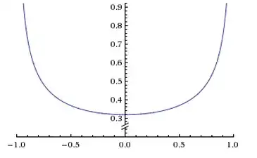

By the Jacobian formula, $$f_Y(y)=\frac{\mathbf 1_{|y|\lt1}}{\pi\sqrt{1-y^2}}.$$ This is the so-called Arcsine distribution, which famously appears in probability theory and in number theory, as shown by two mathematical giants from the 20th century:
$\qquad\qquad\qquad\qquad$
